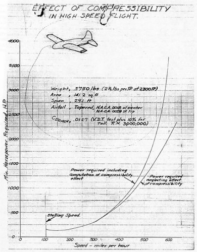

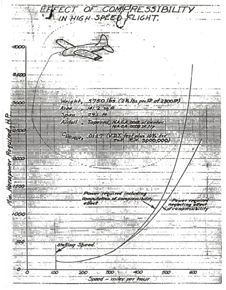

Does anyone here have details on NACA Langley engineer John Stack's 2,300hp Rolls-Royce powered concept pre-dating the X-1? He estimated 566mph for this hypothetical design from what I am reading.
It might pre-date US entry into WW2.

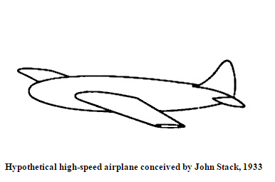

also here is a hypothetical aircraft by John Stack of 1933,for high speed design.
http://history.nasa.gov/SP-4219/Chapter3.html

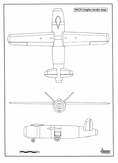

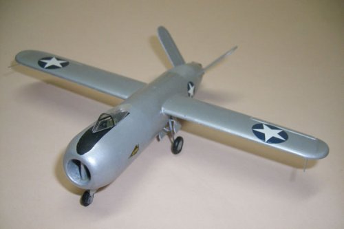

http://www.hyperscale.com/2011/features/jakesjeep72tc_1.htm
This jake's jeep looks like a Convair XP-82. And the story told in the website linked seems to be questionable.

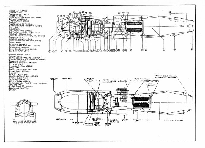

The 'Jeep' nickname for the thermojet (Campini type) was powered by a piston engine
drivin' the ducted fan and a turbo compressor...
The aircraft itself was only designed to investigate the propulsion method

"concept" is a bit of a leap. Its more like a notional design to illustrate an idea.
Jeep technical data
Wingspan: 41.4 ft (12.6 m), lenght: 30.2 ft (9.2 m), height: 9.35 ft (2.85 m), wing area: 215 sq.ft (19 sq.m), fuselage diameter: 5.2 ft (1.61 m), wing thickness ratio: 0.15, estimated profile drag: 0.0153, estimated maximum speed: 550 mph (885 kph), maximum weight: 9,780 lbs (4,430 kg), fuel capacity: 3,060 lbs (1,848 litres) in wing tanks.
