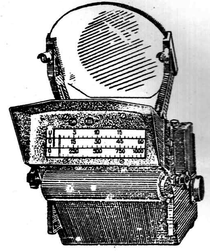

The Su-24 gunsight is called the PPV. I don't have anything on it yet.
The pilot could use his sighting and flight PPV-1 sight - automatic collimator-type gunsight with combination of functions, used to aim at visually visible targets during bombing and shooting. At the same time, information was given for the tasks of aircraft navigation:
- distance to the target or waypoint
route, as well as signaling about maneuvers, once a decision opening fire, abort attack or dangerous altitude.
The calculator PPV-1 was the onboard computer.

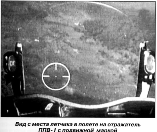

On the plane at the pilot’s workplace the PPV-1V (sighting and flight sighting) is installed. With the help of the PPV, the pilot can aim and use weapons for visually visible purposes.
With the help of the PPV, the pilot controls the bombing, which is performed by the navigator with the RPO, on the PPV range scale there are two arrows - the arrow of the current range to the target and the arrow of the allowed range, as the arrows converge - the bombs leave, the "Fire" lamps flash on the PPV.
With pom. PPV pilot performs a low-altitude flight with an envelope of the terrain - a fixed aiming mark (cross) is a given altitude, and a moving aiming mark (ring) is an airplane.
Below the ring relative to the cross - the plane is below a predetermined flight path, the ring above the cross - the plane is above a predetermined flight path.
The task of the pilot, while controlling the aircraft, is to keep a moving reticle placed on the cross, and therefore fly at a given height with the envelope around the terrain. PPV in this case serves as a command device.
PPV is also used for aircraft navigation. The arrow of the current range shows the distance to the MRP, the arrow of the allowed range shows the distance to the MRP, at which the aircraft will begin to turn on the next turning.
I listed all this for you so that you would understand that PPV is not the last device in the cab, it is needed, it is important.

Hello for long long time i was looking about information for su24 gunsight and also i was looking for its photo in operational mode ; thanks for the pic i want ask you do you have more photo of its gunsight when its on or when its in operational mode also if you have for information im glad to khnow itPPV-1 gunsight - from V. Markovsky & Igor Prikhodchenko Frontal Bomber Su-24 Eksmo (2014)
