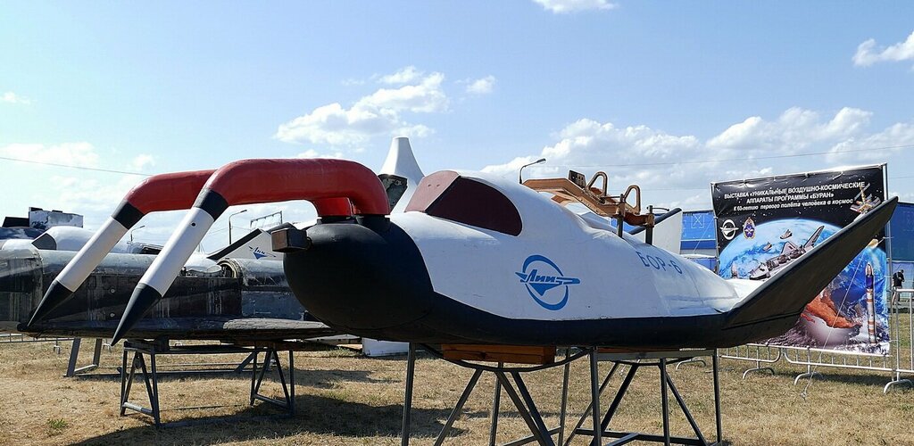

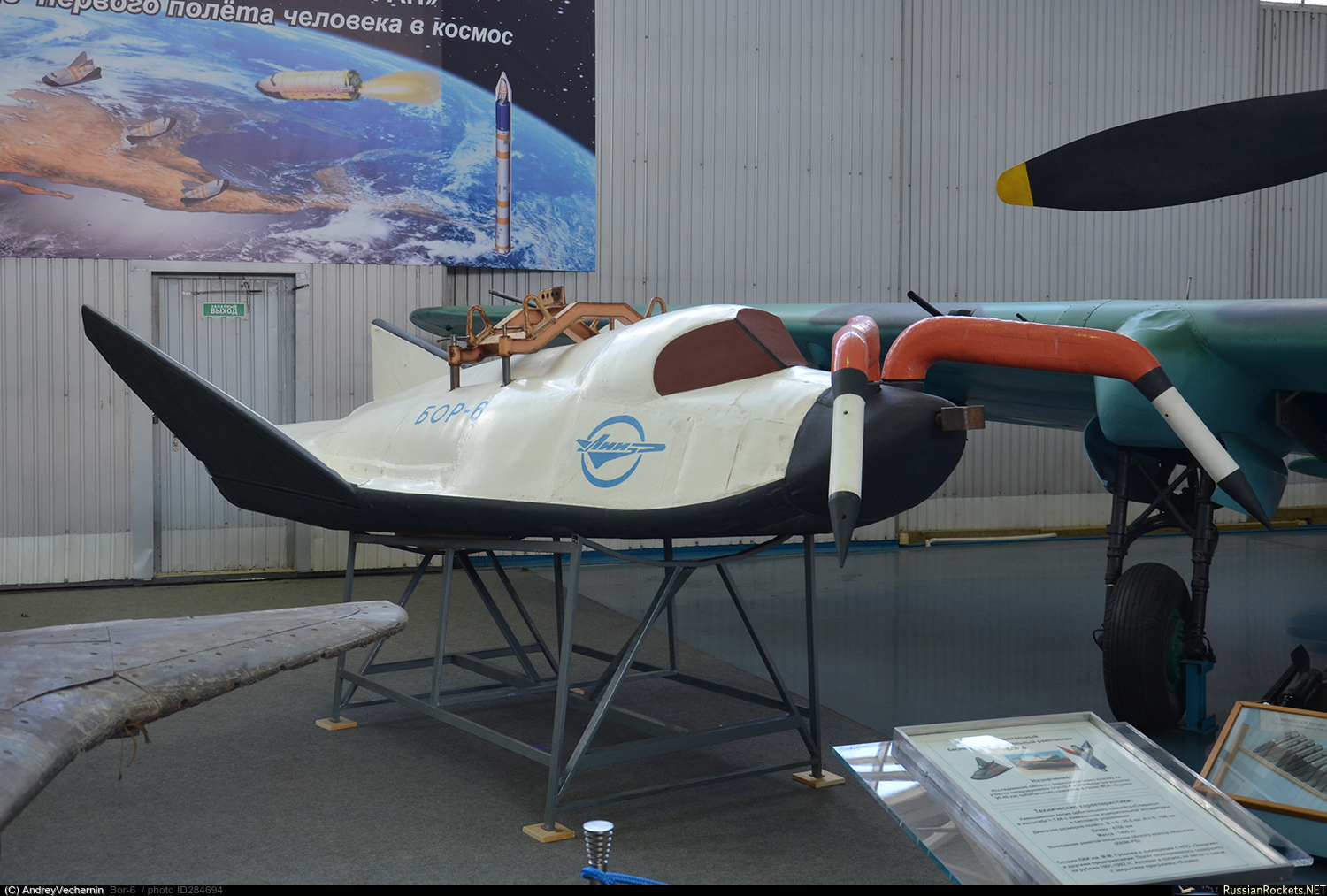

But in theory, of course, everything always looks simpler than the implementation of the idea in practice. Therefore, the BOR-6 project was initiated to test the feasibility of implementing such an idea. This version of the BOR was similar to the BOR-4. However, the ship had two "horns" that were supposed to deploy at the stage of re-entry into the atmosphere. They were positioned in front of the incoming plasma front. This made it possible to keep in touch with the car at any time.
The antennas were located at the ends of these "horns". Their shape was pointed to avoid the formation of secondary shock waves, and with them a large amount of plasma. The horns, which gave the ship the appearance of a kind of space "bug", were cooled by gas. In their production, special ablative materials were used to prevent fire at high temperatures.
