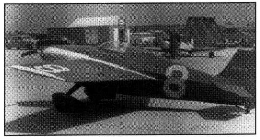

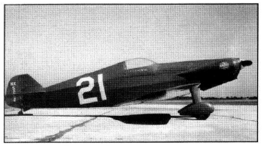

Curtis Pitts did built & flew with success two Goodyear racers before his S-1 biplane:
The "Pellet" in 1948-49
The "Lil Monster" in 1950-51
Source: Goodyear & Formula One Air Racing 1947-1967 by Robert Hirsch
