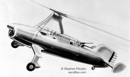

Pitcairn PA.38 attack autogyro
Veeeery nice. Hadn't noticed this on Aerofiles before. I've got the most authoritative book on Pitcairn entitled Autogiro — The Story of "the Windmill Plane" by George Townson (Aero Publishers, 1985), but this project is not included there!
Was it actually expected to attack or are we looking at a purely defensive armament? I take it that the earliest offensively equipped rotory aircraft to be built was sill the Kamov V-8?

From 'Cierva Autogiros the development of rotary wing flight',
Peter W.Brooks, Airlife, 1988, page 226,
"Pitcairn PA-38.
Designation of a series of design studies undertaken
for a USAAC design competition (Spec XC-417, circular
proposal 40-260), which closed on April 22, 1940.
These were of a large jump take-off autogiro of 4,200lbs
loaded weight, suitable for military observation or cargo;
mail carriage; insecticide-dispensing of forest fire-fighting.
Kellett submitted studies of two direct-control designs
without jump take-off capability.
None of the studies was proceeded with.
The Army contract went to Platt-LePage for their XR-1
helicopter."
cheers,
Robin.

It seems to me that the rear gunner would have a very limited arc of fire. Hardly worth the weight of the gun and gunner.
I was just thinking the same, Bill! Unless there was some form of interrupter gear, but that would mean a fixed gun...
