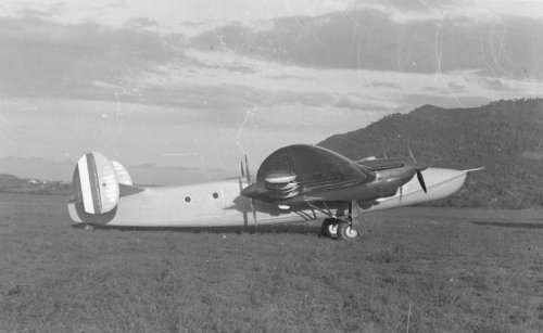

Hi friends!
I'm looking for informations and possibly pictures and drawings about the Piaggio P.23 4-engined transport airplane (Not the Piaggio P.23R that is a totally different aircraft). On the web I found only a picture about the sole prototype built in 1935 and very few data, for example the airplane should be an intercontinental transport with 4 Isotta-Fraschini Asso Xi in tandem position.
I just know that the protoype has been destroyed directly in 1935...
Can you help me?

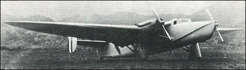

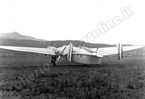

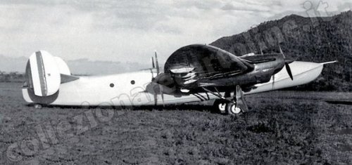

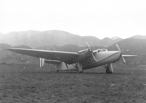

Hi Lucamax,
I found in my archives only two photographs, already posted or quoted in this topic but, at least, not watermarked.
As you know, the life of the P.23M (M for Marino, owing to its emergency capability of ditching) was very short as it crashed on 25 October 1935 during the first flight, killing the 2-man crew.
An official brochure shows the following specifications:
Engines: four Isotta-Fraschini Asso XIR rated at 900 CV
Dimensions: wing span 27.00 m; lenght 16.61 m; wing area 97.5 sq m
Weight: empty 7,387 kg, useful load 11,052 kg, loaded 18,439 kg
Performance: max speed 400 km/h; climb to 4,000 m in 14 min; range 5,100 km
The second prototype, the p.23T, was cancelled (it's possible that the actual building never started).
Unfortunately, no trace of any 3-view drawing
Nico
