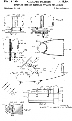

Mr. Alberto Alvarez Calderon also had a patent for VTOL aircraft.

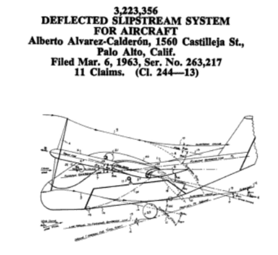

From US patent.
