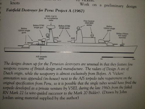

Fairfield Project, 1967.
Possibly the last fully gun armed DD project. Plan was 4x1 120mm Bofors (TAK 120?) and 3x1 57mm/60 Bofors on a Daring hull.
Plan eventually fell through and Peru bought 2 Daring class instead.

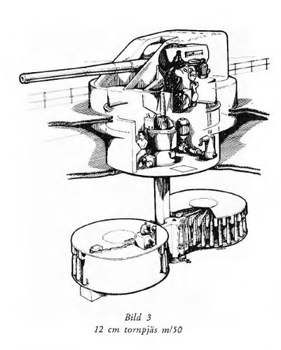

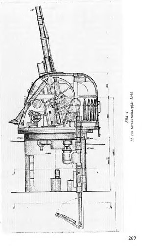

Indeed in the late 1960s it might have seemed that the TAK 120 (12 cm L/46) was to be used in the Peruvian design.
However the shape of the main battery turrets in the drawing from the Warship 2013 (quite schematic, obviously) does not resemble that of the TAK 120. It is much more similar to the single automatic L/50 Bofors gun that was developed in the late 1950s. It had water-cooled barrel, used probably the same ammunition that had been used in the twin gun for the Halland-class destroyers and had rate of fire of 70 rpm. Unlike the TAK 120 it's never gone past the drawing board (afaik).
Source of drawings: "Tidskrift i Sjöväsendet" issue 4 of 1971.
Piotr
