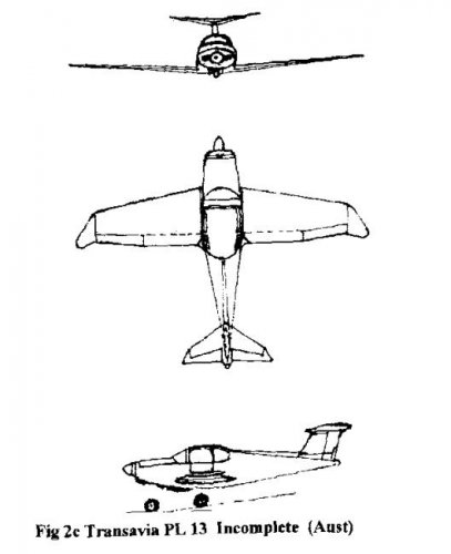

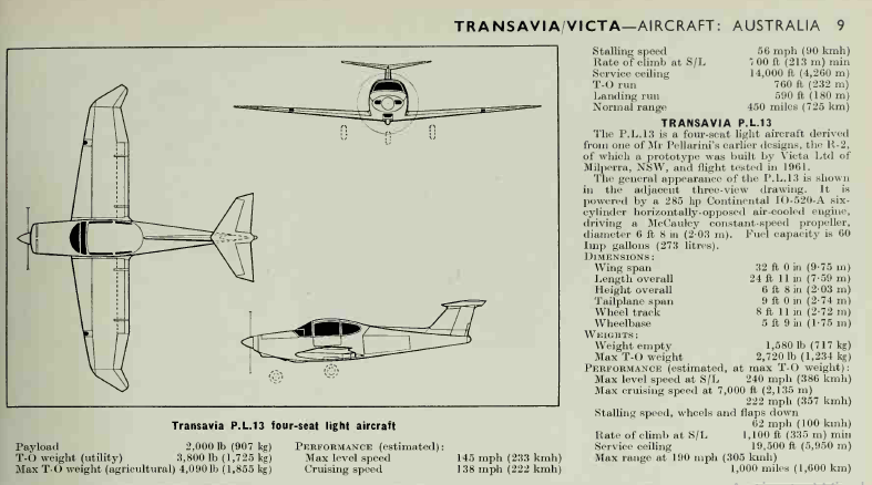

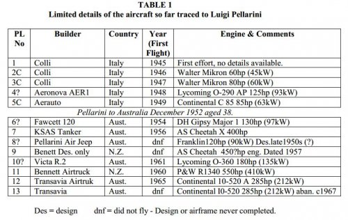

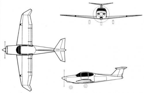

we know that Italian designer,Luigi Pellarini,and his series of PL aircraft,in that
PDF,they spoke about his aircraft and mention that the PL-13 was a low-mid-
wing light aircraft,but in anther site they mention the PL-13 as Air Jeep,who
is right?.
From long time ago,I knew the PL-2,PL-5 and PL-9 as little known aircraft
and projects,for example the PL-9 was a four seat twin boom project of
1958,unfortunately I have no drawings to them,except for PL-5.
http://www.qam.com.au/papers/Luigi-Pellarini-dgc.pdf
http://dbdesignbureau.buckmasterfamily.id.au/aus_projects.htm

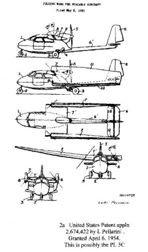

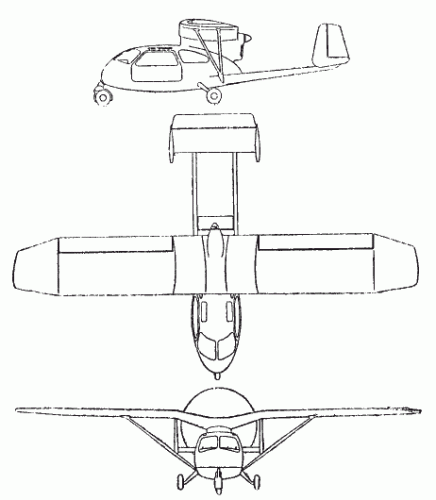

here is a clearer 3-view to PL-13.

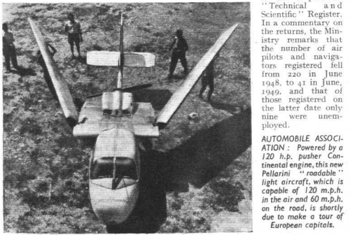

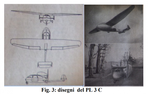

The PL5C was also known as "Aerauto" ("Aircar") at that times, since its capability to recline wings and tour for some time like a mere terrestrial vehicle.
https://en.wikipedia.org/wiki/Aerauto_PL.5C
Luigi Pellarini immigrated to Australia because he believed of any country in the world Australia would most likely need Aircars (aka roadable airplanes). Which he never built in Australia but he did design and see built (in multiple iterations and several hundreds) his Airtruck.

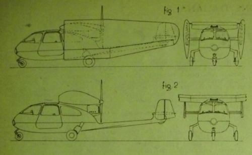

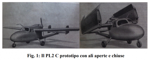

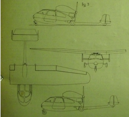

the PL-2C drawings.
http://www.avia-it.com/act/biblioteca/periodici/PDF%20Riviste/Ala/L'Ala%201946%20010.pdf

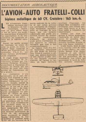

I don't know if his name is Carrozzeria Colli or Placido Colli ?.
"Carrozzeria" is Italian for "body shop" - it was most likely the name of his business.
From Ailes 12/1947,
a more Info about PL-2C.

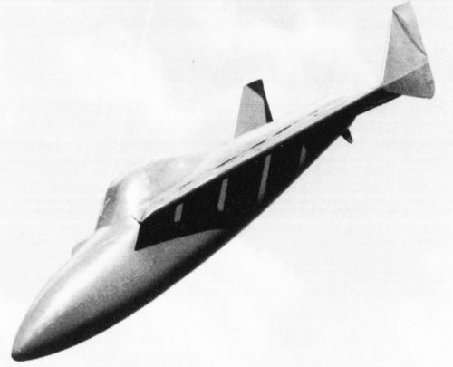

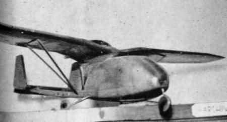

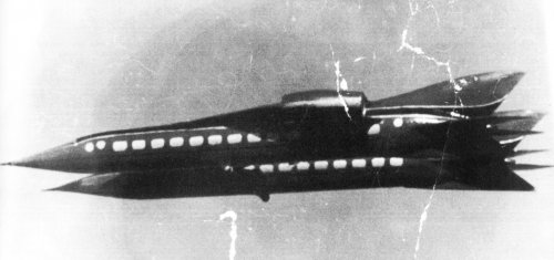

Three nameless Pellarini ideas from Gente dell'aria Volume 6.
1.) Model of a supersonic experimental aircraft
2.) Model of a civil SST
3.) Luigi Pellarini with his model of a three-fuselage aircraft
