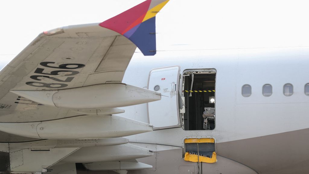

During Landing Asiana-Airlines flight in South Korea (26.05 2023)
Manage a passenger to open the emergency exit door on Airbus A321-200
lucky the Aircraft was 200 meter over ground as it happened and
All onboard were seated with seat belts fastened because the plane was about to land.
and Pilots landed the aircraft safe on ground.
the Man was arrested by Police at Air Port

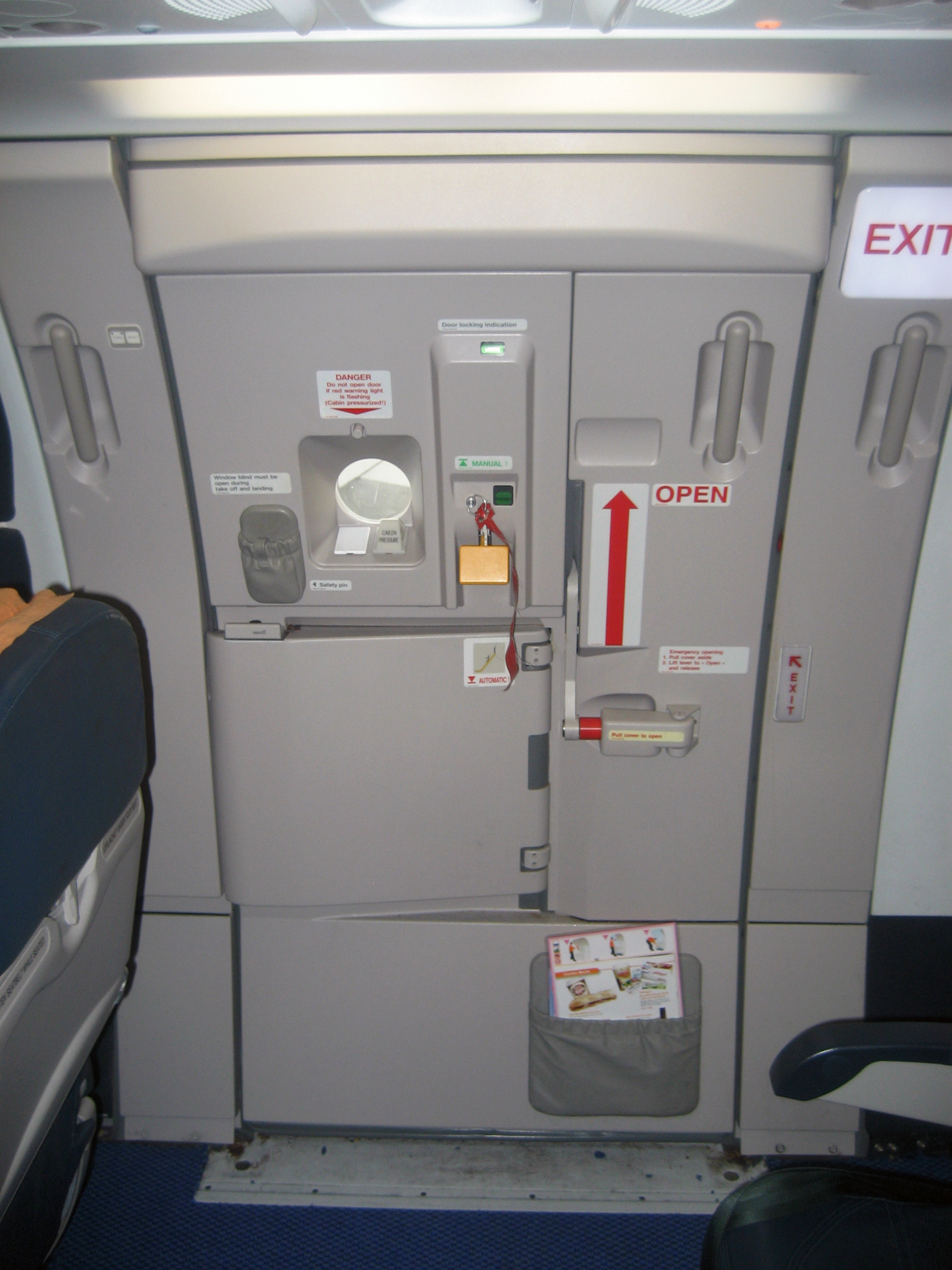

Many airliner doors and emergency escape batches are built like “plugs” so that cabin pressure pushes them against their seals and frames. You need to pull those doors inboard a bit before you can wiggle them out.
Older airlines tended to pressurize cabins to 8,000 feet above sea level, but newer airliners tend to pressurize cabins to 5,000’ ASL. I suspect that lower cabin pressure altitudes are driven by declining health among aging Baby Boomers.
And most airliners deliberately pressurize cabins while still on the ground to prevent this sort of foolishness.

Why should overpressurizing the cabin help keeping a door shut that actually opens outward?
So far i understand open the Idiot a Emergency Exit Door
in contrast to modern airliner door who hold by Overpressure during flight
This emergency exit door is build to open fast and eject a slide for evacuation. (rip off during this event)
The Door in question, the Idiot had make several actions to open it
According dutch NOS news
The man, from the authorities say he is 33 years old unemployed, suffer of some kind panic attack during flight.
and believe he would suffocate and wanted to get out the Aircraft.
The man who try to escape after landing is now under arrest,
Because Police estimation he would try escape criminal prosecution.
he could face up to 10 years prison do his act endanger 200 persons !
Asiana Airlines announce to keep seats next Emergency Exit Doors empty to prevent that again...
