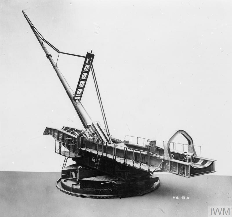

Okay, I got my hands on Paris Kanonen - The Paris Guns (Wilhelmgeschütze) and Project HARP by Gerald Bull (yes, that Gerald Bull) and Charles Murphy through a friend with access to a university library, and it's a fascinating read with original research and fantastic translated primary source documents by Fritz Rausenberger and others. It's leagues ahead of open-source accounts like Colonel Miller's writings and tertiary sources about the subject, along with cutting-edge analysis by arguably the world's foremost expert on ultra-long range artillery.
This being Secret Projects, I want to point out two specific unbuilt designs for the Paris Gun: incremental improvements to the Paris Gun extending its range and caliber before all progress was halted and eventually destroyed after WW1 ended, and a proposal for a saboted sub-caliber munition fired from a regular 35/35.5cm gun.

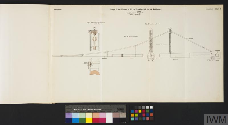

So the first designs are the less interesting one, and I believe all we have left are the few notes by Rausenberger at the very end of his account of the Paris Gun program. Basically, these two incremental design improvements were:
Now, Rausenberger is very sparse on the details here, and no designs or other writings exist as far as I know that corroborate Rausenberger's claims for these improvements. That being said, he's basing these improvements off extensive testing at Meppen and real-world experience firing the cannon, so I imagine there still is significant merit to his claims. Naturally, none of these improvements actually happened, since the war ended and the Entente disarmed Germany.
