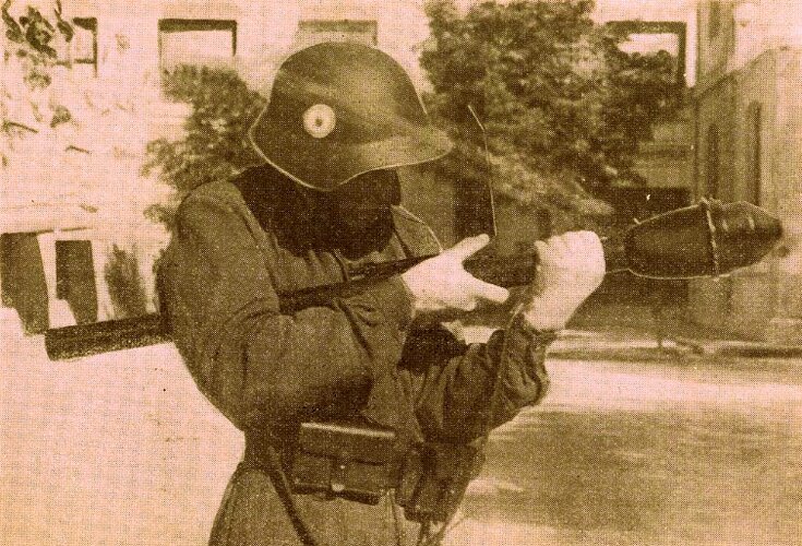

In the immediate post-war years, the Argentine DGFM developed. the PAPI rocket launcher, based on a Swedish. anti-tank weapon Pansarskott m/45 and pansarskott m/46, developed. from the Panzerfaust.

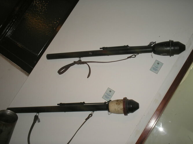

PAPI anti-tank rocket launchers preserved at the Muséo de Armas de la Nación, in Buenos Aires.
