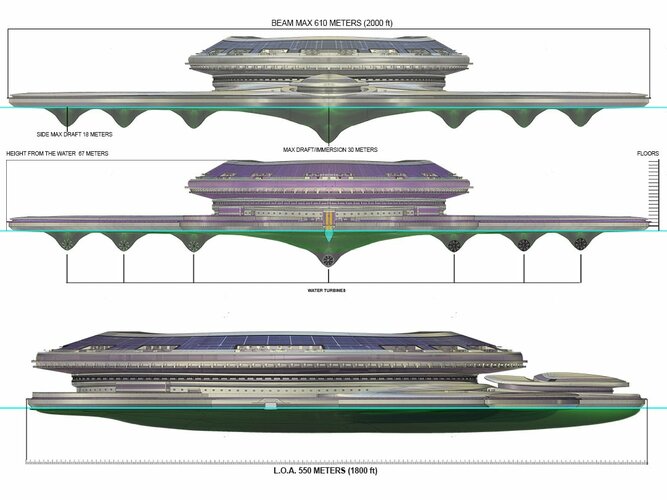

Its like the worst possible design of a boat, forward swept arms with the water pooling around the 'shoulders' with nowhere to go. Its like someone saw a photo of a dead turtle and didnt realises the arms could move while swimming. For Christ sakes its wider than it is long!
Is that a certainty which you have documented?
If not, might want to look at the bows on illustration toward intersection of mid and bottom thirds of page here,

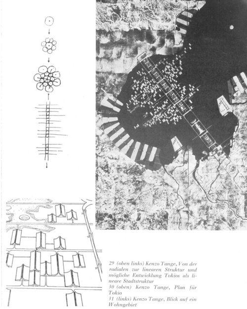

it took to end of 1950s to end 1970s that the idea resurface
special in Japan that needed living space
allot of those concepts were concrete floating Cities
special Architect Kisho Kurokawa and Kiyonori Kikutake were obsessed with this idea.
in USA Buckmister Fuller also prosed floating Cities, even one that float in the Air ! (Cloud Nine)
(there were other concepts like Seacity or Tokyo bay Expansion but those are pile dwelling)
Yes, they show that the arms are below the waterline their entire length (ok not the tips) with 3x15m draught engines on each side and a 30m draught in the centre. With nowhere for the water to go its going to pool higher than sea level until the pressure allows it to be forced under the boat, meaning increased water resistance. Its not designed like a catamaran to ride up out of the water as its maximum speed is 5 knots. In addition if you are still unsure that the arms are clear of the water they have said it will have wave energy converters in the arms to generate electricity from the waves breaking against it to provide the ships motive power.

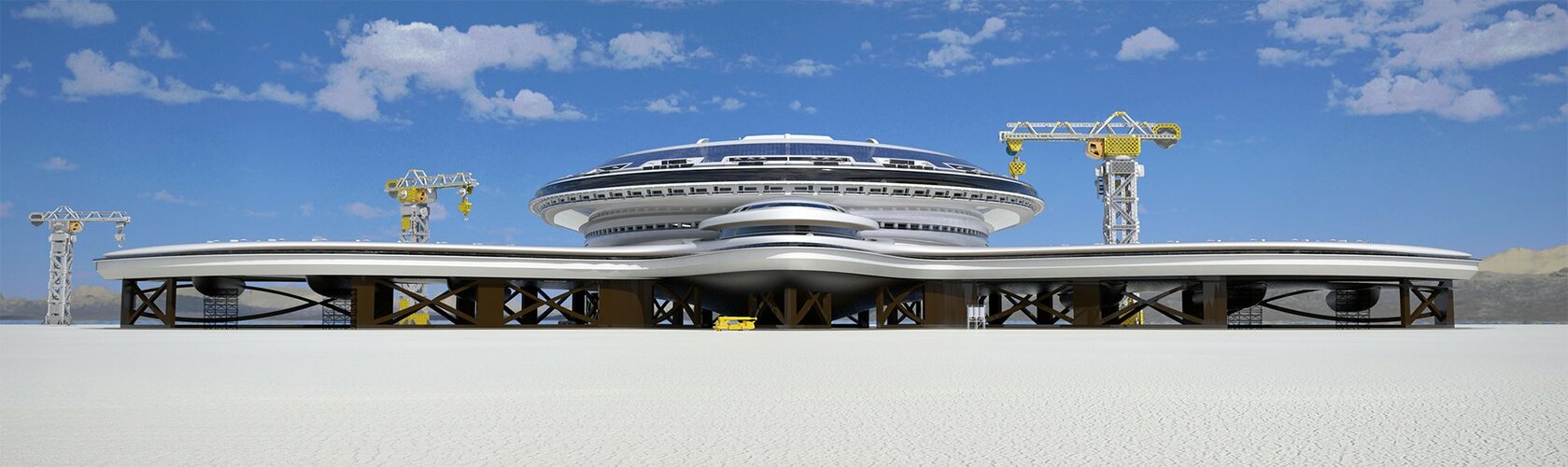

Fundamental difficulty with these kinds of hare-brained ideas. Sooner or later you have to dry dock it for survey and maintenance.
Yes, the whole thing. You can't detach bits and do it that way. That's not how it works.
Where do you do it? And what do you do with 60,000 semi-permanent 'guests' (plus a comparable number of service workers, mostly from low-income counties) during that time?
