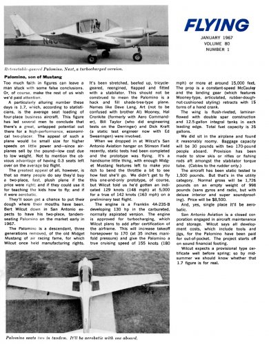

The Midget Mustang lineage is confirmed in this article from Flying dated January 1967 (see attachment):
http://books.google.fr/books?id=CFLFuZzLe_4C&pg=PA15#v=onepage&q&f=false

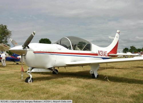

Attached photos of N40J as Omega II, the Omega III N31AE and the Texas-Turbo N64TT

The plot thickens!!!
Obviously a much more complex family line than initially believed, since the Omega III is quite different now from the Midget Mustang!
Thanks a lot for these new contributions.

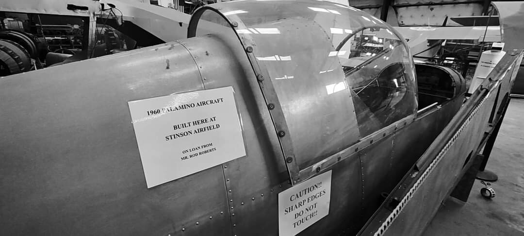

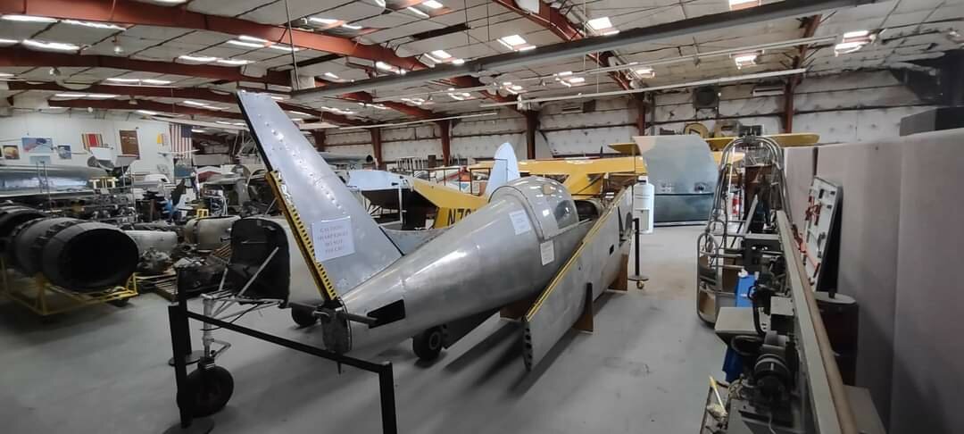

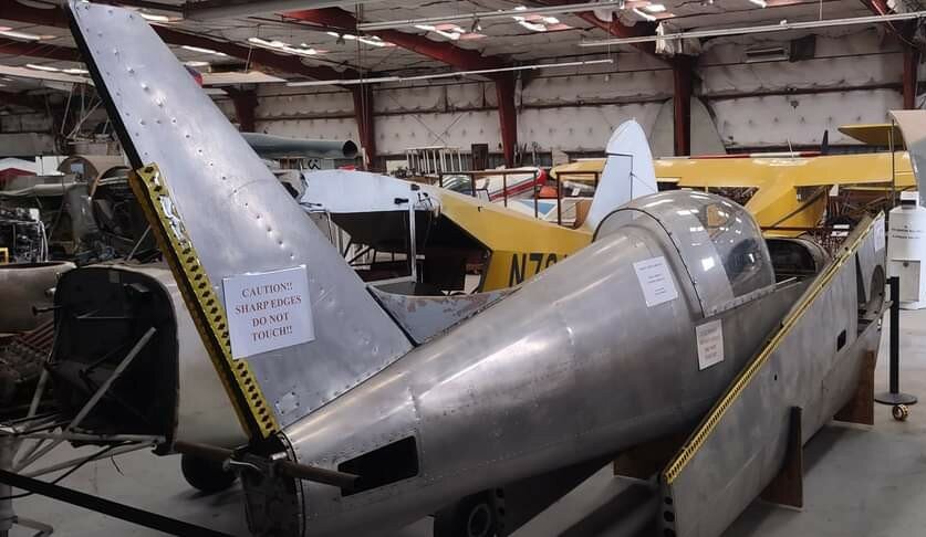

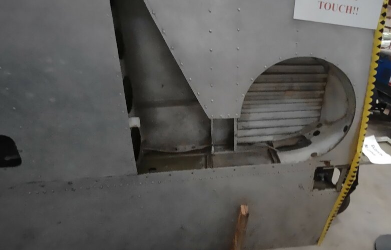

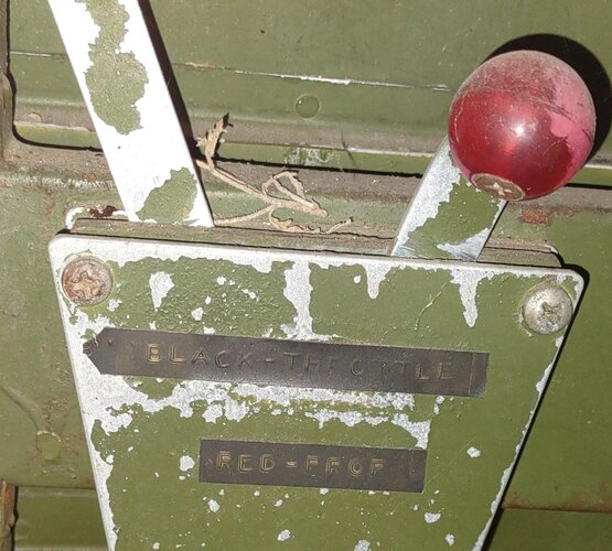

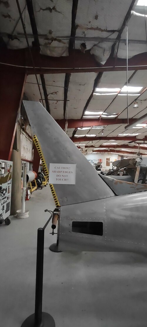

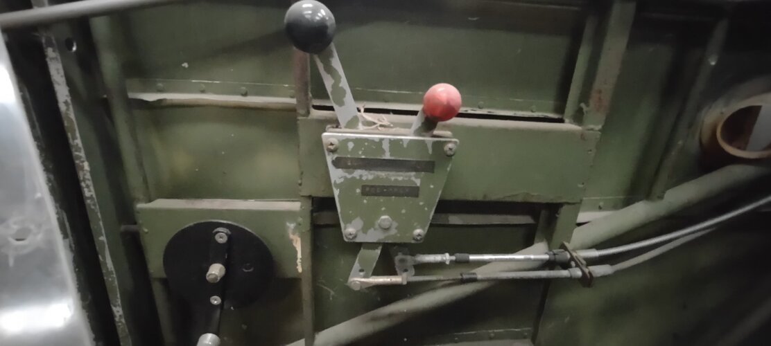

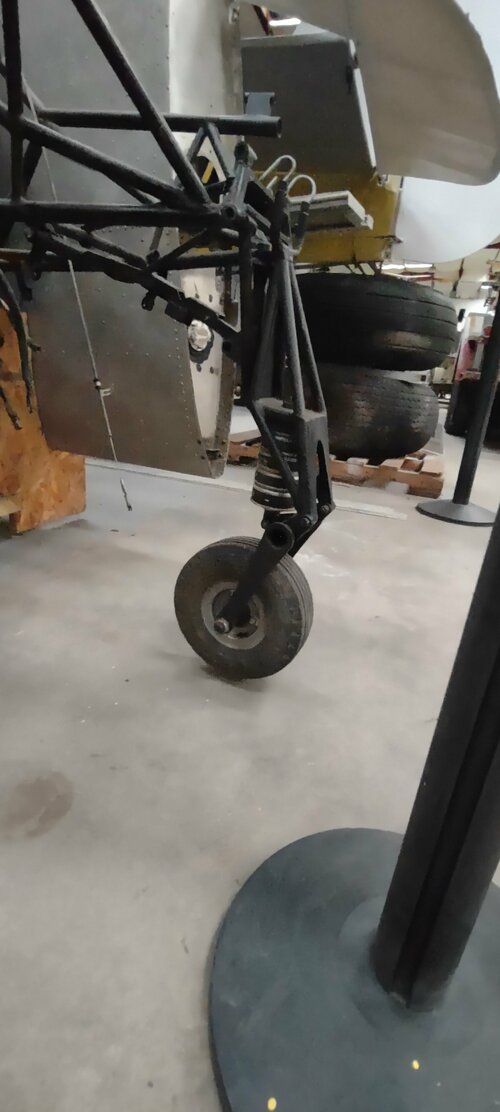

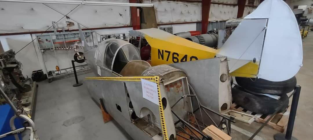

I don't know if anyone is still following this post, but I have attached our museum's Palomino. No data information has been found but a deeper inspection is needed. The only written info is on the levers mount.
