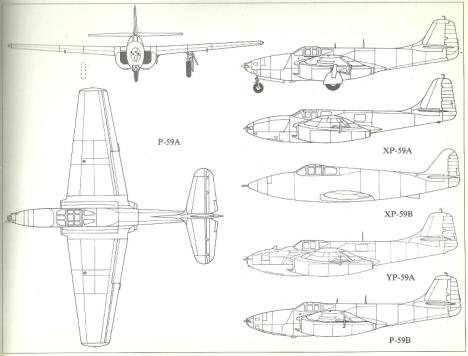

The P-59 Airacomet was only as fast as the Thunderbolt and Mustang, so if the Japanese had deployed the Karyu, Shusui, Kikka, and jet-powered variant of the Shinden, and the USAAF had used the Airacomet in the Pacific theater, the P-59 would probably have been outpaced by the Ki-201, J8M, Kikka, and J7W2 because those aircraft were faster than the Airacomet.
What was the real hold up for the Airacomet? What would it have taken to have made it a world beater? More powerful engines? Different airfoil for the wing - i.e. what Bell selected was too drag inducing? Different air intakes to make them less drag inducing? What was it about the P-59 that kept it back in comparison to the P-80 and the Gloster Meteor or the Me-262?
It was nothing more than a test aircraft, unsuited aerodynamics for transonic speed and powerplant still in its infancy. Once knowledge adquired, it was obvious to develop better designs.
So, no chance for whatiffery because, while waiting for the P-80, the P-51 was the choice.
History of the development of the P-59 here, including problems encountered by the USN. By Oct 1943 it was clear it wasn’t worth pursuing performance wise so production contract cut from 100 to 50 aircraft delivered through to mid 1945 for training and trials.

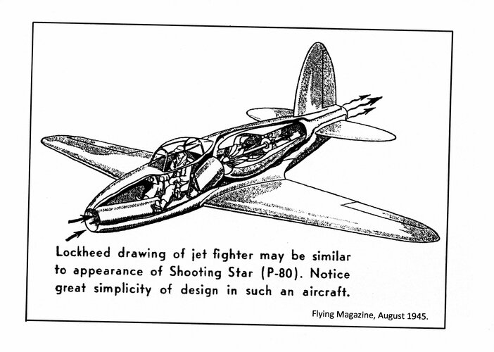

In the original XP-80 design, published in Flying Magazine-August 1945, the aircraft was fitted with one circular nose intake, but after criticism received by the nose air intake of the L-133, the designers also decided to use lateral air intakes, with the armament installed in the nose.

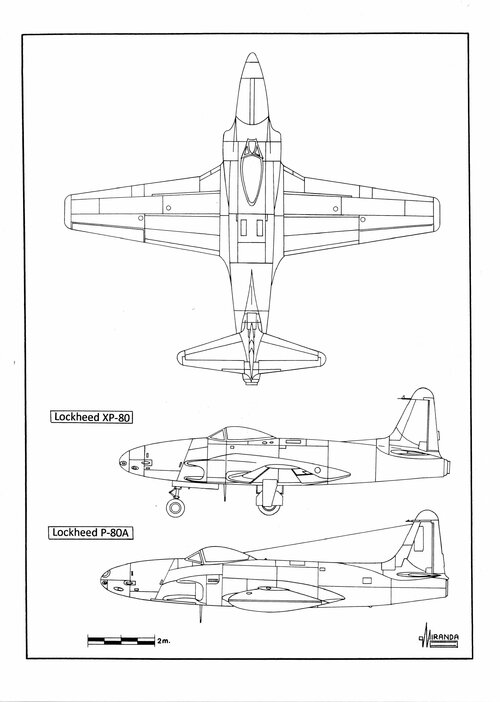

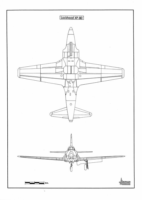

Lockheed XP-80 (Model L-140) technical data
Power plant: one Halford H.1B centrifugal turbojet with 2,460 lbs (1,114 kgf) static thrust, wingspan: 37 ft (11.29 m), length: 32.8 ft (10 m), height: 10.17 ft (3.10 m), wing area: 240 sq. ft (21.6 sq. m), maximum speed: 502 mph (808 kph), maximum weight: 8,859 lbs (4,019 kg), climb rate: 3,000 ft/min (915 m/min), service ceiling: 41,000 ft (12,497 m), armament: six 0.50 cal nose mounted M3 machine guns, with 200 rounds per gun.
Lockheed P-80A Shooting Star technical data
Power plant: one General Electric J33-GE-9 centrifugal turbojet with 3,850 lbs (1,774 kgf) static thrust, wingspan: 38.8 ft (11.83 m), length: 34.5 ft (10.52 m), height: 11.3 ft (3.44 m), wing area: 237.5 sq. ft (21.4 sq. m), maximum speed: 558 mph (898 kph), maximum weight: 11,700 lbs (5,300 kg), climb rate: 4,580 ft/min (1,396 m/min), service ceiling: 45,000 ft (13,720 m), armament: six 0.50 cal nose mounted M3 machine guns, with 300 rounds per gun.
