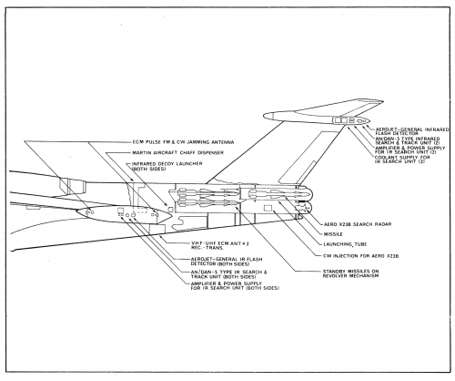

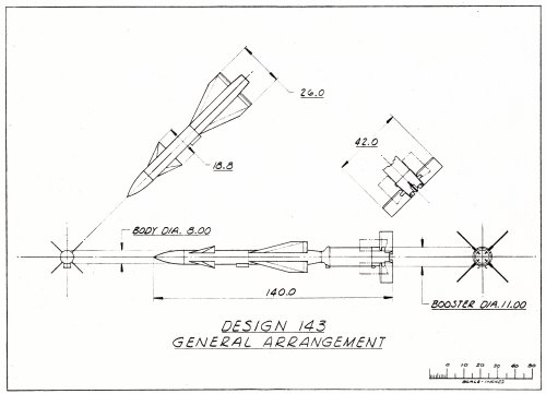

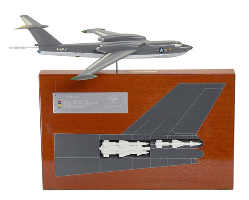

A little bit of info on the Grumman Design 143 Bushfire rear-firing SARH missile system that would have been fitted to production Seamasters: http://www.tboverse.us/HPCAFORUM/phpBB3/viewtopic.php?f=6&t=20500
Attached image courtesy of MKSheppard at the above link.
Text from that is:
One of the least-known projects undertaken by Grumman during the late 1950s was the Bushfire rear defence system for the P6M-2 strategic flying-boat then being developed by Martin for the Navy. Whereas the two XP6M-1 prototypes had a twin-gun tail turret, production P6M-2s were to have been fitted with the Grumman Design 143 Bushfire system using SARH (semi-active radar homing) missiles launched to the rear. As shown in the accompanying drawing dated 15 January, 1957, one missile was carried in a launching tube, ready to be fired as soon as an enemy aircraft was detected by the Aero X23B search radar. Four to six additional missiles were carried on a revolver-type housing forward of the launching tube. Cancellation of the P6M-2 programme resulted in the demise of the Bushfire system.

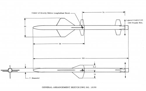

The competitors for the P6M Bomber Defense Missile circa 1 JULY 1957 were:
Grumman -- best of the submittals, but the missile and its complete system was considerably overweight.
Bendix
Motorola
Avion
Sperry

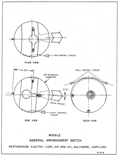

Emerson (Spherical missile)
Westinghouse (Spherical missile)
Admiral
Solar
In the end none of the submittals fully met the specifications, and they couldn't be developed in time to meet Seamaster deliveries. Plus, the weight of the BDM system aggravated the already serious balance problem in the P6M.
This combined with budget cuts, killed the Seamaster BDM.

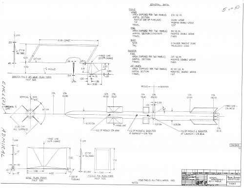

EDIT: Of note is that it appears ADMIRAL used Beech Aircraft of Wichita as a subcontractor for its BDM Project, per the drawing having Beech markings on it.

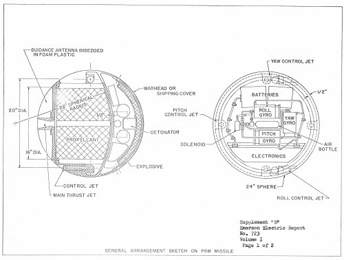

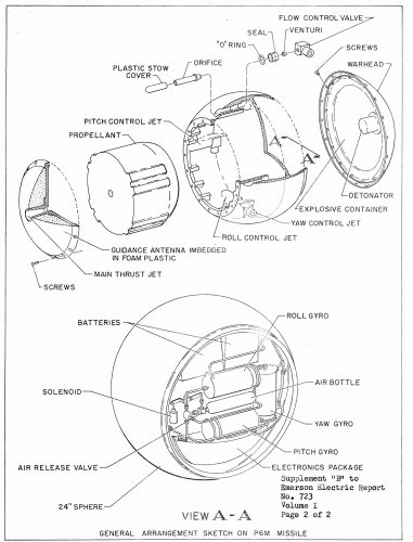

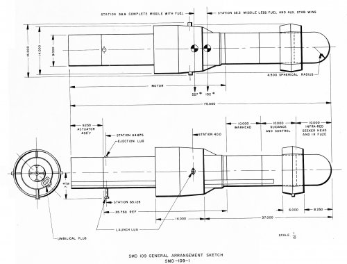

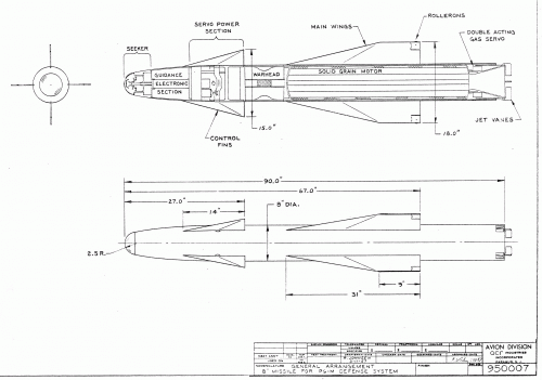

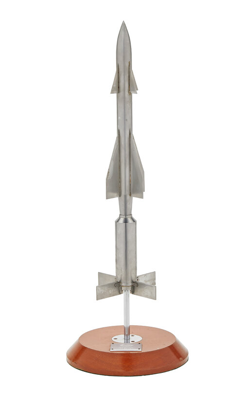

  • Windtunnel model of Grumman Design 143 Bushfire AAM for Martin P6M SeaMaster.jpg
Spilt to own topic. Grumman's BDM proposal seems to be quite related to their airframe for the Bendix Eagle.

Also, those spherical missiles are weird. I thought Pye Wacket flying saucers were weird, exploding softballs take the cake.
And yet B-52s kept tail guns, as have all the Russian heavy bombers.
They retained them because they might be useful against visual range attacker (and because they already were installed). The logic was mostly that missiles could be diverted by decoys or jammers, but guns couldn't, and if missile attacks failed, enemy fighter would most likely attempt the gun attack.
Well, the idea was to attack enemy supersonic fighters head-on on late 1950s tech. The electronic was bulky and only analogue circuits could be fit into missile. The supersonic aerodynamic was a quite novel area of research. So the idea of spherical missile - which would not have much difference turning sharply in any direction - was quite attractive.
