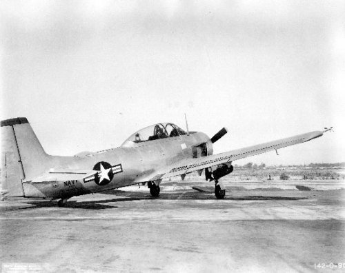

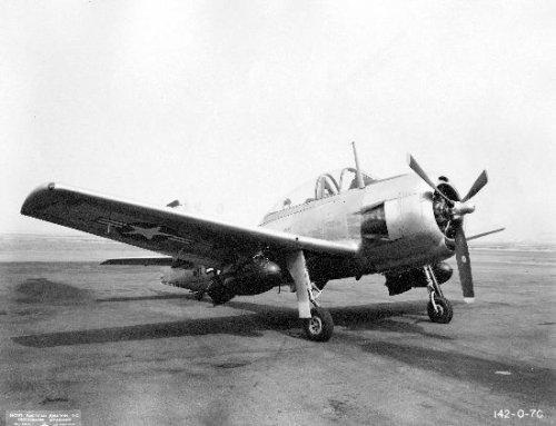

And in fact, this is exactly what North American did when they developed the taildragging XSN2J-1 into the XBT-28...

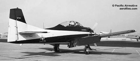

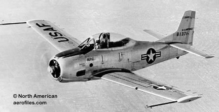

Just realized I'd accidentally posted an ill-labeled picture of the competing Fairchild XNQ-1 instead of the North American XSN2J-1 Texan II. I've replaced the picture above with an appropriate one. Here is a set of two more pics, the first being the XSN2J-1, and the second the Nomad, ultimate development of the T-28 by North American.
