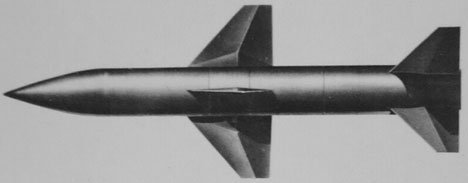

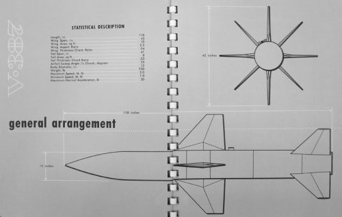

Here are a few images of the Chance Vought Proposal, a general arrangement,
and a couple of artwork pieces.

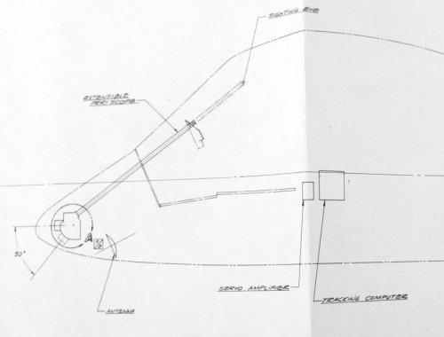

For the V-387 proposal they selected the Wagner Optical System. The WOS is an aided system. There is an optical system
that superimposes the target and missile and action automatically sends the correct signals to the missile to make it seek
the sight line.
