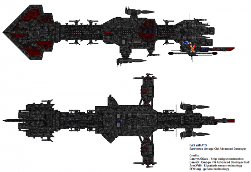

Closest I can come up with, read the bit about the 'counter-battery darts'. Following attachment is modern line warship design (Earthforce Omega-class destroyer, ca. 2297 CE) fitted with this system.
B)
