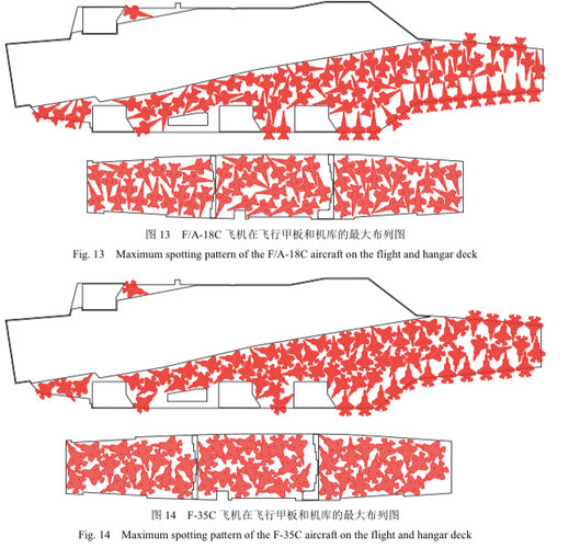

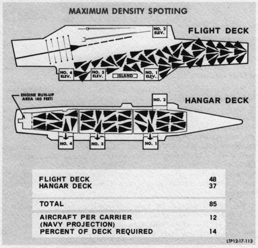

To do this correctly, you have to look at spot factors and density factors, not just aircraft numbers:
Spot factor (F/A-18C =1.0)
F/A-18C 1.0
F-8E 1.08
F-4J 1.24
F/A-18E 1.24
F-14 1.32
F-35C 1.16
F-111B 1.53
A-7 0.85
A-6 1.2
EA-6B 1.23
S-3 1.25
E-2C 1.71
MQ-25 1.1 (estimated)
CMV-22 1.21 (estimated)
SH-60 0.51
SH-3 0.70
Maximum density spot (CVN-68)
157 A-7s
130 F/A-18Cs
112 F-35Cs
105 F/A-18Es
However the above is purely a theoretical exercise (see pictures below). In practice the realistic maximum operational density is roughly 70-75% of this number, i.e.
91 to 97 F/A-18Cs
78 to 84 F-35Cs
74 to 79 F/A-18Es
(The max density used to be 75-80% during the Cold War but the current optimal density is now lower in order to increase sortie rates). In fact the 2025 CVW in the slide posted by @timmymagic has a density of only ~65%.
The density of the air wing you’re proposing is… 92% (!). To get it down to 70-75%, you’d have to cut it down to:
36 F/A-18E / EA-18G (-12)
20 F-35Cs
10 MQ-25
5 E-2D (-3)
4 CMV-22
10 MH-60 (-10)
In other words today’s super carriers max out at around 70-75 fixed wing (plus ~10 helos on top of that).
