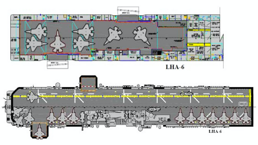

Could a variant of the America Class be built, optimized as a Carrier (CVL or CVS [perhaps with angled deck + EMALSs and AAG]), to compliment, but not replace, existing Nimitz and Ford Class ships? Can it be modified to fill the role of the Essex Class CV/CVS of the 60's & early 70's? Can it be constructed in a shipyard not currently building America Class ships? Everyone recognized the US Navy needs to grow. There is a need to expand the carrier fleet, along with every other type of platform. Can a ship like this be designed and built in an expeditious manner? We have an existing hull platform. If so, what would its optimized air wing looking like for both independent operations and as a part of larger carrier strike group? I welcome anyone's thoughts. Thanks!

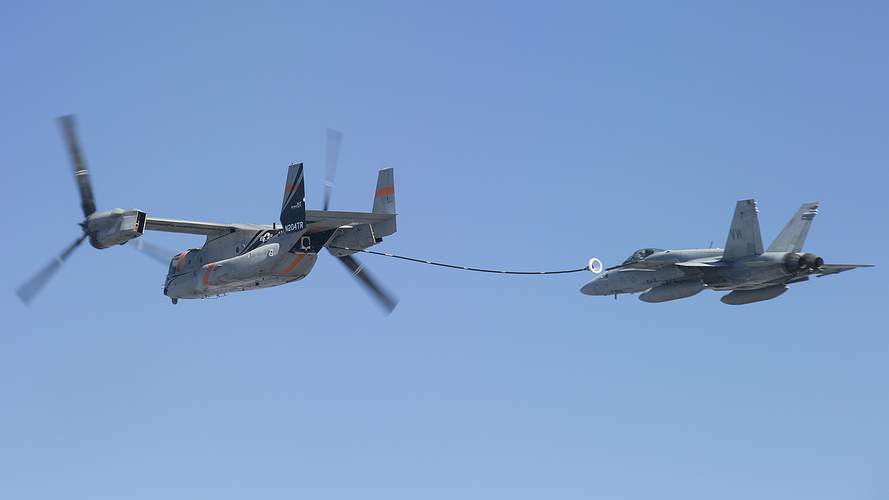

  • Note that this doesn't include any tankers. IF you want tankers, you need at least 2-3 to keep one in the air 24/7.
And that's just for the minimum self protection and operational capabilities. 3x AEW (5x if helicopters), 6-8x H-60s, 8x F-35s, 2x CMV-22, (optional: 2-3x more CMV-22 as tankers). Except for the AEW, you do NOT need an angled flight deck for this to work, and the Merlin AEW is an existing, off the shelf buy (but not in the USN inventory right now). That's 19-26 aircraft already, and that's already getting close to the carrying limit of the ship without enlarging the flight deck.

For a strike platform, you will want another 8-10x F-35s, and that will be limited because it doesn't have EA-18G Growlers for EW support. Adding Growlers will only be possible with an angled deck, and you would want 2-4x in the air wing.
