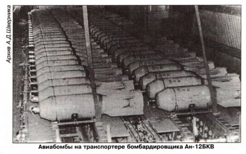

During the Indian-Pakistani war at 1965-66, the Indians sometimes used their An-12s as night bombers. And they were successful enough: during some raids they carried as much as 16 tons (!) of bombs. Here are some memoirs about this:
http://www.bharat-rakshak.com/IAF/History/1965War/An-12s.html
http://www.bharat-rakshak.com/IAF/History/1965War/An-12s-2.html
Once the Antonov was intercepted by the Pakistani Mirage, but escaped successfully!.. This Indian practice suggested the Antonov designers to make a special bomber version of the An-12. The An-12BKV was built in 1969; it was fitted by stationary conveyor (named TG-12MV) for bomb dumping, and could carry a bomb load up to 12 tons (70x 100-kg bombs, or 29-32x 250-kg, or 18-22x 500-kg bombs). It also could be used for mine-laying, carrying 18x UDM-500 aerial mines. I attach an interior photo of An-12BKV, with the conveyor loaded with bombs.
(The main source: An-12 monograph in "Aviatsia i Vremya" (Aviation & Time) magazine, No.1/1995)
And if you remember the Atlantic and Orion/Aurora, you also must not forget the Il-38!

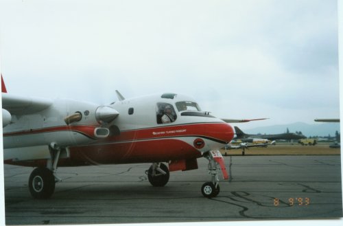

Really stretching the definition and showing off (I'm in the right seat as I was in a Navy S2F in 1956 as a kid, almost 40 years earlier), but it is a turboprop and a bomber, albeit of fires...
