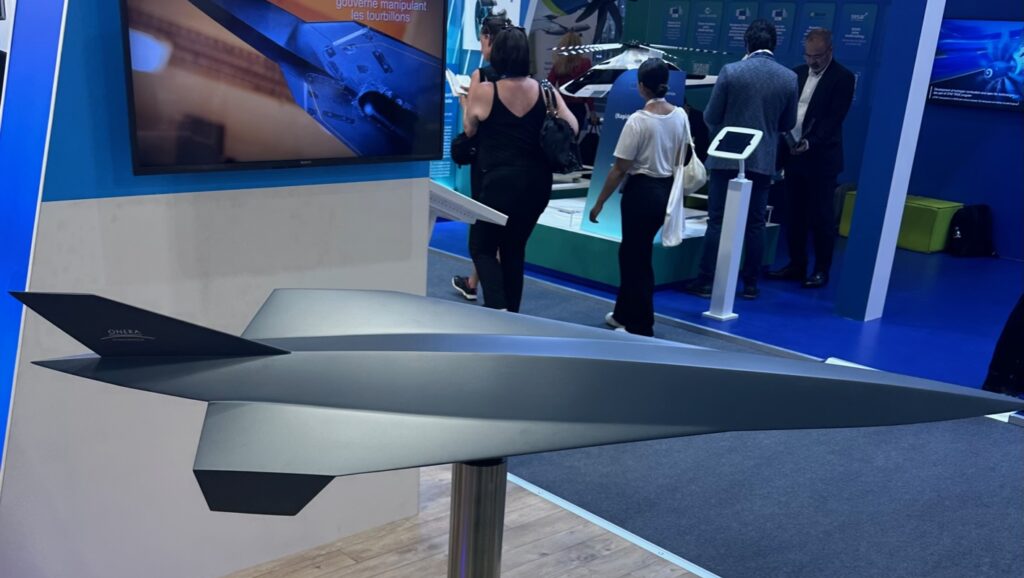

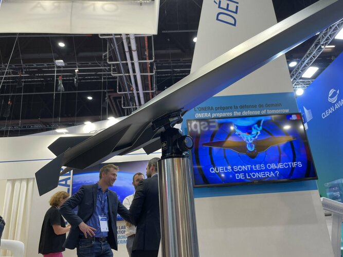

"Fighter" might be doing some heavy lifting here
Those engines look tiny for Mach 5. Maybe a bank of 4+ turboramjets with common inlet and exhaust? Or maybe totally made up?
It’s not a fighter. I believe it’s meant to explore the potential for a future unmanned nuclear vector to replace the ASMP-A missile.
It would take-off, accelerate to Mach 4, cruise to target, accelerate to a penetration speed of up to Mach 7, somehow drop a nuclear weapon, then return to base.
I admit I’m skeptical…
Blackbirds demonstrated clean drops at Mach 3. As long as there's no plasma shock wave, targeting is relatively easy.
Thanks. Is there some French language reporting that says more?
I'm surprised at a potential bombing role rather than ISR. Anything about what munitions it might drop? Surely not gravity bombs in 2050.
Ah, now all those crazy references to Space Fighters that keep cropping in French articles criticising SCAF finally make sense.
I always thought it was journalistic fanboy fantasy but no it seems that ONERA really have been doodling this one...
I wonder if you actually have read what ONERA's guy said at presscon...
Yes and I noted that only the English-language media use the word “fighter”. In French the term being used is “avion hypersonique”… which is a lot more open ended than “chasseur”.
Connecting the dots to the French MoD’s current emphasis on hypersonic penetration for their nuclear vector, it seems likely that nuclear will be the core mission. Though given the timing (2050+) this would not be an immediate replacement for ASMP-A (that would be ASN4G).

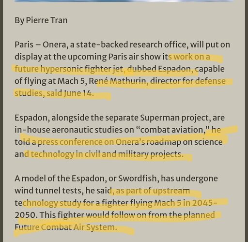

@flateric words matter. “Avion de combat” is not the same as “avion de chasse” or “chasseur”. By contrast NGF is specifically referred to as a “chasseur nouvelle génération”. It is therefore my strong belief that it is incorrect to refer to Espadon as a fighter.
Furthermore, it is also important to remember that FCAS/SCAF is a system of systems designed to perform several distinct missions, from nuclear penetration to air superiority. So just because Espadon is meant to be a follow-on doesn’t mean it will do all the SCAF missions - the nature of hypersonics mean that it should be focused on deep strike, which in France is always first and foremost a nuclear mission.
Whoa whoa, stop bickering, a cursory glance at the text shows it is unclear, switching back and forth between two different concepts.
I wonder again if you have read not only text on slide, but what ONERA's Mathurin said to [native speaker] journo.
Bottom line: that article is a generic speaking mess. It mixes three things

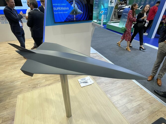

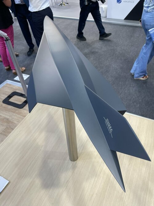

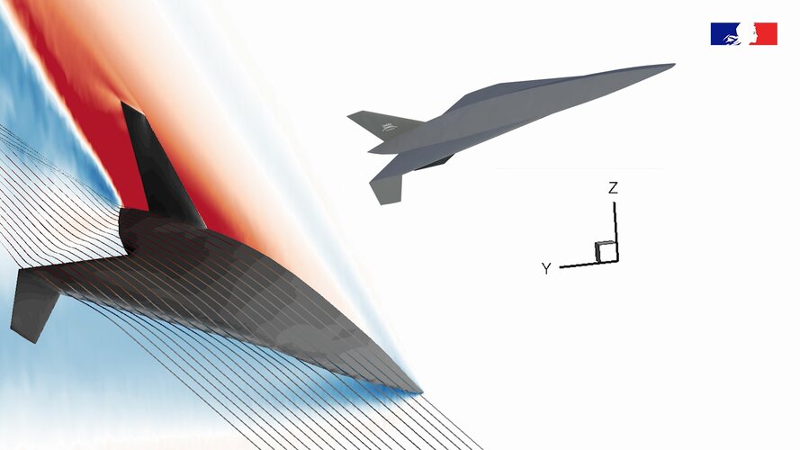

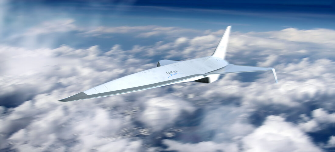

More info that clarifies the role of Espadon, from a journalist who interviewed the Onera team:
1) Program goals: The goal is not strictly speaking to build a hypersonic aircraft for the French forces. Rather they want to develop a generic model of hypersonic combat drone in order to improve ONERA's virtualization and simulation capabilities. And even more importantly, it will help model the hypersonic threats that the French forces will have to counter in the future.
Basically, this is pure research which will allow MBDA, Thales and others to develop and improve their detection and interception systems at very high altitude. Though one day it could be used to develop a French hypersonic missile/drone/plane.
2) Technical details
a) The model will be of an aircraft approximately 40 meters long, flying between Mach 5 and Mach 10, at an altitude of approximately 30km.
b) The wings drop down to become stabilizers during cruise flight, much like the XB-70
c) Propulsion would be provided by hybrid turbojet/ramjet engines
d) The model will have a ventral weapons bay allowing the launch of projectiles at hypersonic speed. These will be mainly gliders as they won’t have to accelerate themselves.
Like I said… not a fighter.
