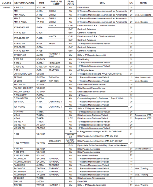

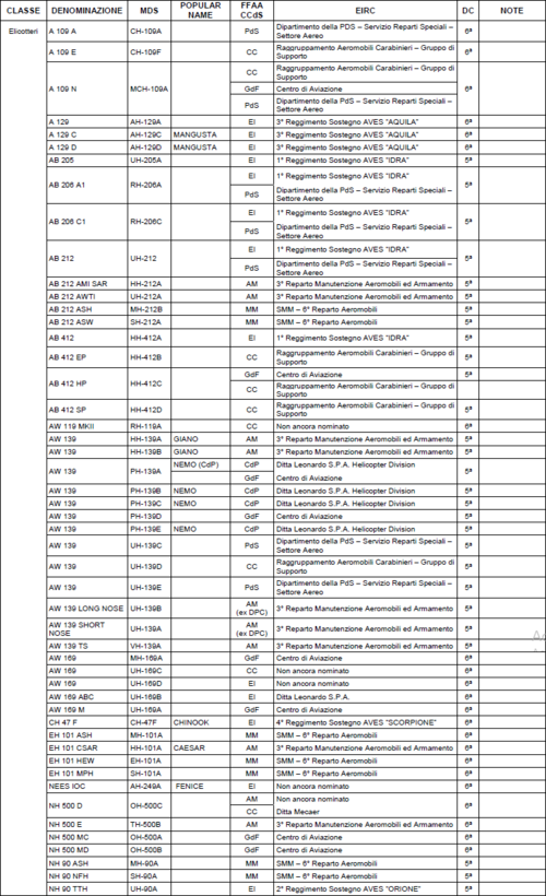

After coming across several military designations that looked suspiciously American, yet weren't, I had to dig a little further and found out the reason: the Italian government has chosen to "take inspiration" from the US system, as clearly explained in this official Italian Ministry of Defense document which I translated via Google Translation. Please note that bold type is mine, and meant to emphasize parts of the document which I thought interesting and relevant to the subject.

Adapted from the following source (also attached below):
https://www.difesa.it/assets/allegati/35792/aer_ep_.0-0-12_em.2_ed_16-10-2024.pdf

- It is undeniable that absolutely ALL Italian military designations in the 2022 system follow as closely as possibly the American DoD's method of designating aircraft: identical mission letters (A-Attack, C-Transport, F-Fighter, G-Glider, H-Helicopter, P-Patrol, Q-UAV, T-Trainer), but also mission modifiers (E-Electronics, H-SAR, M-Multipurpose, O-Observation, R-Reconnaissance, S-ASW, T-Trainer, V-VIP) are all used in the exact SAME manner. In fact, you won't find another military naming system that is as close to the American one as the Italian one is!
- Apart from the ATR-42/72 series which uses the same two digits as P-42A/B, C-42C, P-72A/B, C-72A and the single-digit German Ventus/Nimbus gliders (G-2B, G-4D/DM), the bulk of the Italian military designations is made up of three-digit numbers adapted from company model designations; VC-319A (Airbus A319), UC-228 (Dornier Do 228), VC-900A/B (Falcon 900), E-550A/C-550A (Gulfstream 550), T-339, -345 and -346 (AerMacchi MB 339, M 345 and 346), EC-/VC-180 (Piaggio P 180), A-/TA-200 (Panavia PA 200), U-208 (SIAI 208), T-260 (SIAI Marchetti SF 260), MH-/EH-/HH-/SH-101 (EHI EH 101), G-103A (Grob 103), and of course all the Agusta/Agusta-Bell/Agusta-Westland (now Leonardo) helicopters;
- Then, you will find that when it is possible, some types reuse the same designations as their American equivalents: TAV-8B, AV-8B Plus, C-130J/-30, F-35A/B, KC-767A, CH-47F, RQ-11B/C, RQ-12A (Wasp AE), C-27J.
- However, you will also find some designations/names which are similar or related to the US ones, but not quite identical: MQ-1C Predator A+ (NOT Gray Eagle), MQ-9A Predator B (NOT Reaper), RQ-7C Shadow 200 (although not a US DoD designation, it follows right after the US RQ-7A/B), RQ-27A ScanEagle (the US has it as the MQ-27A/B);
- Finally (and that's the greatest source of confusion), you will find many designations that look like they could be part of the US system but are in fact totally specific to the Italian system and can therefore cause confusion when you find them out of context: A-11A/B, TA-11A/B, C-42C, VC-50A, UG-17A, TZ-1A, and of course all the local UAVs: RQ-10D/F, RQ-12A (Sixton), RQ-24A, RQ-25A, RQ-26A/B, RQ-28A, RQ-29A, RQ-30A/B, especially since they do not use the company model designators, but a sequential numerical system.
