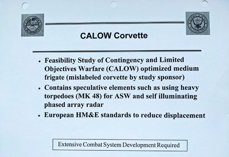

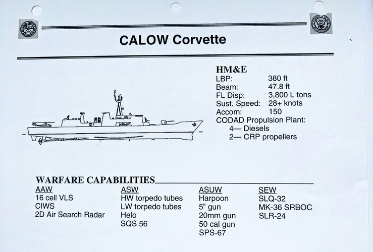

Up first, the "CALOW Corvette."
Contingency and Limited Objectives Warfare (CALOW) was a fairly new buzzphrase for an old idea -- warfare below the level of peer conflict. IN this context, it seems to refer to the idea that this ship was designed to fight enemies other than the high-end Soviet (or by this point Russian) navy.
So, we see a bigger gun that recent USN frigates, a small self-defense SAM battery, heavy CIWS (they appear to be Goalkeeper), significant secondary guns (the description says 20mm, but the mounts behind the bridge wings look very large for 20mm). The inclusion of both heavyweight and lightweight torpedoes is unusual . [I wonder if the idea was actually to use the Mk 48s for ASuW as well, since the sonar suite is actually quite basic.] The all-diesel propulsion plant implies much more endurance but not much interest in quieting.
The radar situation is confusing. "Self-illuminating" is an unusual term -- I think it refers to the radar being able to do both search and fire-control illumination, but a 2D radar for fire control would be decidedly weird.
It's interesting that the helicopter shown is an AH-1, not a traditional Navy helicopter. Possibly hearkening back to Persian Gulf operations with Army/SOCOM AH-6s and later Marine AH-1s on Navy escort flight decks.
The radar looks like a SPQ-9B, which can guide ESSM, though I'm not sure if that really counts as 2-dimensional still.
SPQ-9B doesn't have an illumination capability. Ships with SPQ-9B rely on other systems for ESSM fire control (Mark 9 TIS on non-AEGIS ships, SPG-62 on AEGIS ones)
Edit: The closest analogue I can think of would be something like a rotating SPY-3. But I don't see how you could do CWI from a rotating antenna unless it's actually two antennas back-to-back (like Sampson). I suspect the drawing here was a placeholder for a radar that didn't actually exist when they sketched this design.

I disagree re: quieting on the diesels. Rafting and Prairie Masker often aren't mentioned in warship statistics and equipment lists at this stage. It could easily be present and desirable when facing non-peer adversaries who have submarines. Given the Proposed ASW fit, I think it would be warranted.

The ASW fit is pretty mediocre in my opinion (no mention of TACTAS or VDS, and SQS-56 is not SQS-26/53). The US preference was for rotating machinery (turbines) over reciprocating (diesels) for quieting.

"European HM&E standards to reduce displacement"
Wondering if NAVSEA thinking of relaxing their SLA, sea life allowance standard at that time, Weight and Stability Limits for Naval Surface Ships, which specified 10% for weight growth and 12" for vertical center of gravity for new design and new flights of USN surface combatants. Understand the goal posts had to moved and the 9096 standard drastically lowered due to weight growth in both LCS classes which were only able to achieve ~1.5% for future weight growth .
PS Ships inevitably get heavier throughout their 25 to 35 year lives and become less stable, as new equipment and systems are added above the center of gravity.

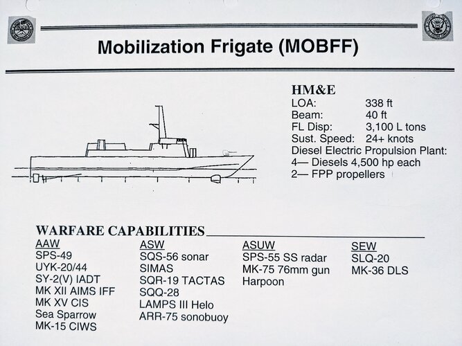

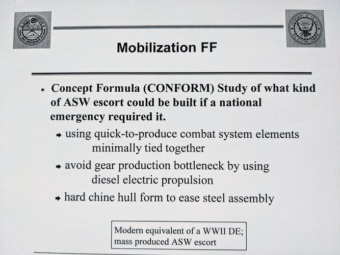

Second design, a Mobilization Frigate. This is a very austere ship designed to show what could be done to build an ASW escort very quickly without a sophisticated combat system or other equipment. Precise timeframe is unclear, but I'd guess mid-to-late 1980s (maybe just before the fall of the Soviet Union).
The choice of diesel-electric propulsion is unsurprising in a design that was explicitly calling back to WW2 DE concepts. The HP listed lines up very closely with contemporary diesel-electric locomotive plants; I would not be surprised if that was intentional, so they could use existing production lines for those engines.
Nothing shocking in terms of combat systems (other than how basic it all is). "SY-2" should be SYS-2, a track manager/integrator. Sea Sparrow isn't obvious in the drawing, but I'd guess it would be some form of Mk 48 VLS or possibly even an old NSSM launcher. Basically everything on this ship could have been recycled or procured very quickly from existing production lines.
Whoever drew this had limited graphics resources; note the Mk 45 gun mount scaled down in lieu of an actual Mk 75 76mm gun, for example. There are no antennas shown, but the SPS-49 would presumably have gone on the lower platform with SPS-55 at the masthead. Phalanx likely at the aft end of the hangar roof (a la FFG-7) with the Sea Sparrow somewhere forward of that, either at the front of the hangar roof if NSSM or in the break between the hangar and bridge superstructure if VLS.
An odd design, but very interesting.
The omission of ASW torpedoes seems an interesting move for a ship that is identified as an ASW escort. You could make the case for ditching the Harpoons for a couple of triple tubes.
The SQS-56 looks quite far forward, not sure that would be an ideal position, especially in heavy seas.
I would concur on Sea Sparrow choices, as NSSM atop the hangar or there might be space for an 8 or 16-cell VLS between the Mk 75 and Harpoons. Another option could be single-cells along the hangar like the Karel Doormans.
I'm not a huge fan of OTS torpedoes -- by the time you can use them, you're probably dead anyway.
SQS-56 is at about the same place in the FFG-7 as well. Thankfully, it's not the primary ASW search sensor in either design. As long as you can keep the tail streamed and straight, that's job #1.
That said, this ship is most likely going to be pure misery in heavy weather anyway, with the hard chines, a lot of flat-plate construction, and no stabilizers.

I wouldn't disagree but they were de rigueur at that time and there's nothing wrong with a close-range last ditch if you are escorting a high-value convoy/carrier.
Yes I guess it is pretty much in the same place - always looks too far forward to my eye but then I'm not a hydrodynamicist!
I've seen pictures of Type 81s and Leanders with their sonars nearly visible during seakeeping trials with heavy slamming and the Leanders were quite good seaboats.
North Atlantic ops would be interesting I agree! Though the chine might have reduced spray affecting the upper decks.

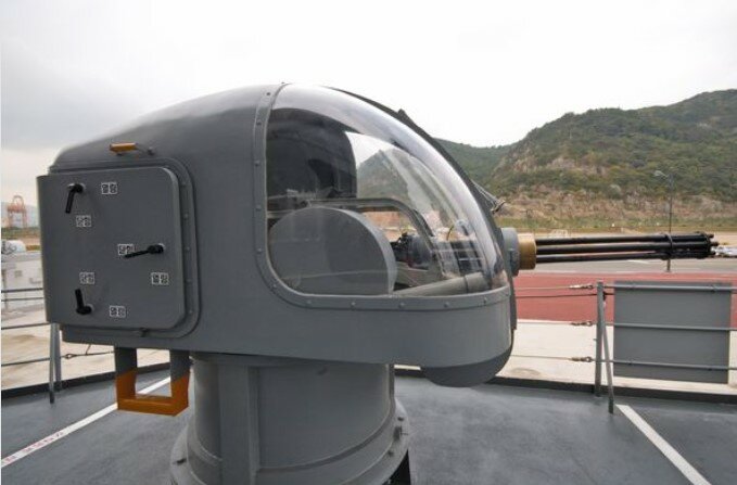

The 20mm gun mount on the CALOW design indeed weird it looks like quite a large gunhouse and by 1994 an older looking one, closer to the twin 40mm Bofors fully enclosed mounts of the 1970's like the OTO-Breda Fast Forty or Compact! Which adds another question as to why use two kinds of CIWS weaponry on a single ship?

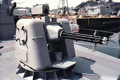

I wonder if it might have been something based on a 20mm Vulcan. Both Japan and Korea have such mounts for "policing" type duties, which would line up with the CALOW mission space. Neither matches this mount in detail, but the concept could be similar.
ROKN Sea Vulcan

As to why have both, the Goalkeepers would have still been largely dedicated anti-missile systems, while a 20mm gun like this would be mainly for small-boat targets. The notion of adding surface mode to CIWS was just starting to emerge at this point (fielded in 1999 in Phalanx, and later than that in Goalkeeper, I think).
Those wing guns remind me of the dual 30mm “EX-74” by Emerson Electric, very distinct design.
Quite possible, on closer inspection of the drawing. There is at least one other design in this brief that lists "20mm guns" under ASUW when the drawing clearly shows something else. It might have been a quirk in the author's dataset or something.

The CALOW design was more of an ASW boat that the Lafayettes, which notoriously were completed without sonar. It's true that rafting the diesels did make the Lafayettes rather quiet, but the USN preference was clearly for turbines (the ship-service diesel generators on the FFG-7s were regarded as a step back on quieting from the SSGTs on the Spruances, for instance.
The CALOW design looks to have some modest RCS shaping, similar to the Burkes. Enough to improve CM performance, not enough to seriously impact overall detectability.

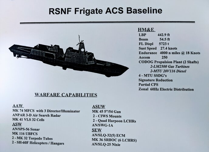

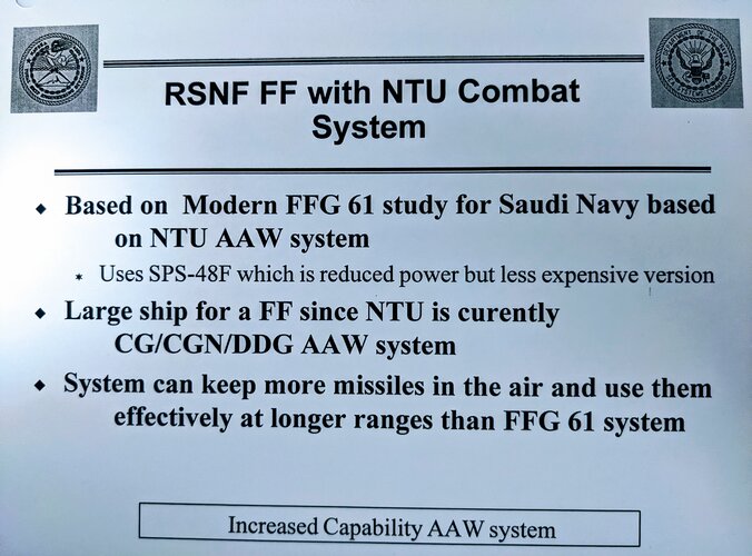

So, as it happens, those export studies were next up. (PXM turns out to be a rabbit hole -- Friedman and this brief only referenced one of about a dozen configurations that were done under PXM around 1985-86, with multiple different hull technologies and equipment standards. That's probably going to be a separate thread at some point, when I get to the bottom of it.)
The FMS export frigate studies were done by Gibbs & Cox for a Royal Saudi Naval Force (RSNF) frigate requirement that was eventually fulfilled by the Al Riyadh class (a Lafayette AAW variant). Combat Fleets 1995 reports that the Saudis were looking specifically at the AEGIS version. As of September 1992 other candidates being considered were a modified Halifax-class frigate with Sea Sparrow, or FF-21. Which certainly covers the full range of capability, consistent with Saudi's usual acquisition strategy.

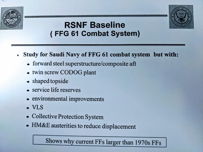

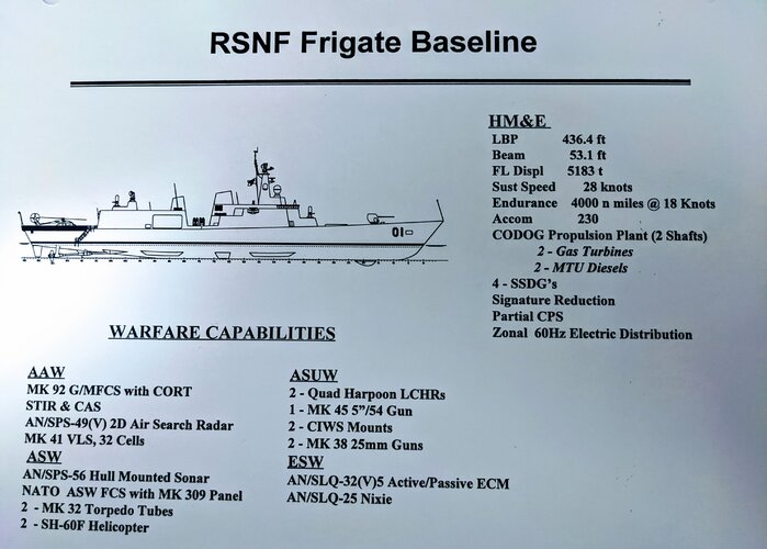

So, the interesting thing is that there are three versions that differ only in their radar and weapon control systems -- FFG-61 CORT, New Threat Upgrade (NTU), and the AEGIS Combat System (ACS). The actual armament was fixed across the three baselines: 32 Mk 41 VLS, 8 Harpoon, 1 Mk 45 gun, 2 CIWS, Mk 32 torpedo tubes, and 2 LAMPS III size helos. Same for the EW suite, which was SLQ-32(V)5 with Sidekick and the usual SRBOC launchers plus Nixie. ASW seems to be limited to the hull sonar (SQS-56, despite the typo across all three slides) and LAMPS III helos, with no mention of towed array or VDS.
So, displacement starts at 5183 tons for basically duplicating FFG-61 (~4100 tons) with reset service life margins, a second shaft and auxiliary diesel engines, a steel and composite superstructure with some stealth shaping, and updated armament.
Swap out the FFG-61 combat system for a version of NTU and the displacement jumps up to 5640 tons. And you add about 20 crewmembers.

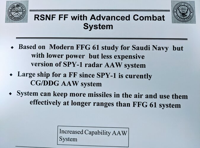

Jump to ACS with ANPAR (SPY-1F) and displacement rises again, to 5723 tons. (Something weird happens with beam here; the heavier ACS version manages to be narrower than the NTU version, despite being longer and appearing to have more weight high. Not sure how that happened, but stability calcs can be weird. Or it could be another typo.)
RSNF Baseline 1.jpg RSNF Baseline 2.jpg RSNF NTU 1.jpg RSNF NTU 2.jpg RSNF ACS 1.jpg RSNF ACS 2.jpg
Thanks, very interesting. Sounds like what the Saudis got in the end with the Al Riyadhs was an intermediate capability closer to NTU than AEGIS (DRBV-26 + Arabel + Aster 15).
I think it's really hard to compare, but Arabel supposedly can support 16 simultaneous engagements, which is more like AEGIS than NTU. The fact that ASTER doesn't require terminal illumination makes it a lot easier to do simultaneous engagements, of course.
Second design, a Mobilization Frigate. This is a very austere ship designed to show what could be done to build an ASW escort very quickly without a sophisticated combat system or other equipment. Precise timeframe is unclear, but I'd guess mid-to-late 1980s (maybe just before the fall of the Soviet Union)...
How quickly could you build one during wartime?
No idea. DEs took between 6 months to a year of active construction time during WW2 (some spent longer, waiting for workforce or materials availability). These would probably be similar, but would likely run into the same kinds of supply bottlenecks that the DEs hit -- availability of engines, production of weapon systems, manpower shortfalls, etc.
Interesting that the dimensions were stated in between perpendiculars while modern ships mostly states overall length more often then waterline.
Also one source states Goalkeeper CIWS while other drawings shows Phalanx
LBP seems to be preferred by naval architects. Not sure why exactly.
Which design are you looking at specifically that has the Goalkeeper/Phalanx mismatch?
