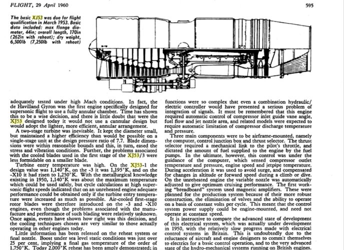

Some "rubberized" GE X-84 turbofan data (according to Andreas Parsch, the X-84 is the TF31):
