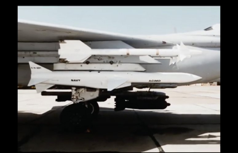

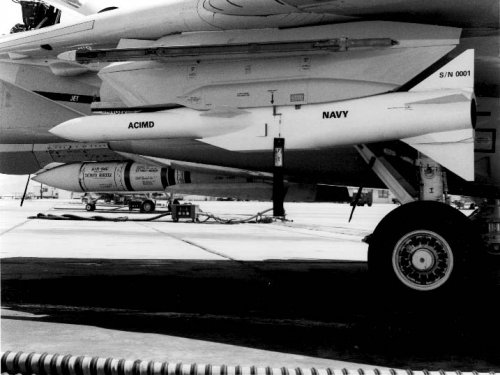

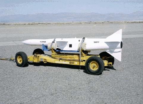

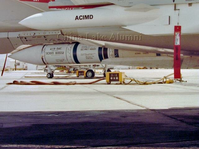

Often mentioned in relation to AAAM / AIM-152, this is actually the NWC (Naval Weapons Center) ACIMD, which was a prototype of a long range AAM concept.

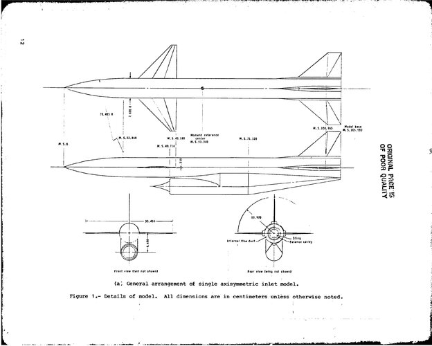

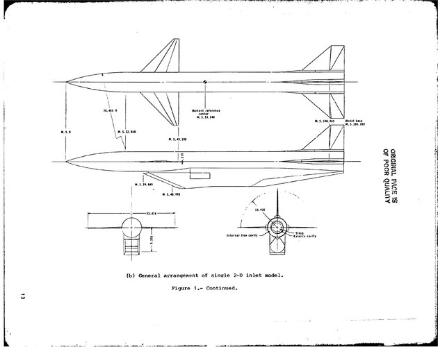

Is there a link to any website and/or document(s) that go into detail on this study? I checked over at the wikipedia and while there's a mention in some articles there's no article on the study itself.
NASA-TM-84557 Aerodynamic characteristics of a series of single-inlet air-breathing missile configurations
Two tail configurations were investigated: a tri-tail and an X-tail. The tests included body-inlet, body-inlet-wing, body-inlet-tail, and body-inlet-wing-tail
configurations.
