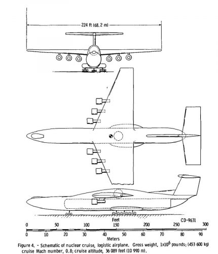

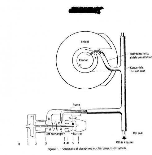

While searching the NTRS for information on subsonic airliner designs, I found what seems to be the last nuclear powered aircraft proposal.
It was a hybrid aircraft using conventional fuel for take off and then transitioning to nuclear power at cruising speed/altitude
See:
1. Preliminary Study Of A Nuclear Cruise Airplane Having A Helium-Cooled Thermal Reactor
http://ntrs.nasa.gov/archive/nasa/casi.ntrs.nasa.gov/19720063062_1972063062.pdf
2. Comparative Flight Envelopes for Three Different Design Point Subsonic Nuclear Airplanes
http://ntrs.nasa.gov/archive/nasa/casi.ntrs.nasa.gov/19720063064_1972063064.pdf
