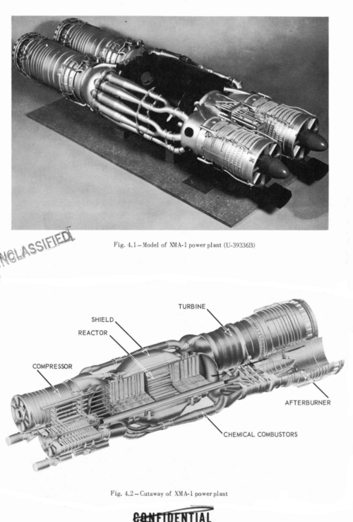

X-211 or its official designation XMA-1
is a one-reactor with two-engine package with a direct cycle
after a study for the Weapon System 125-A, it had 2x XMA-1 units
however:
The X-211 engine development was to be an experimental turbojet development
capable of supporting requirements of the reactor development program,
and no plans were made to carry the engine to production qualifications.
source

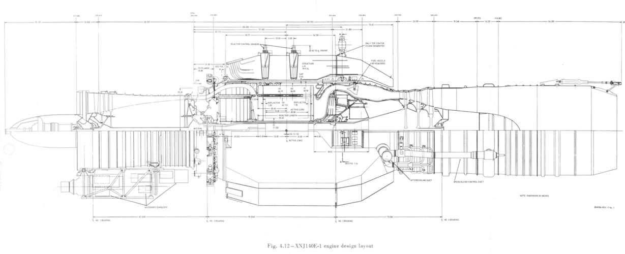

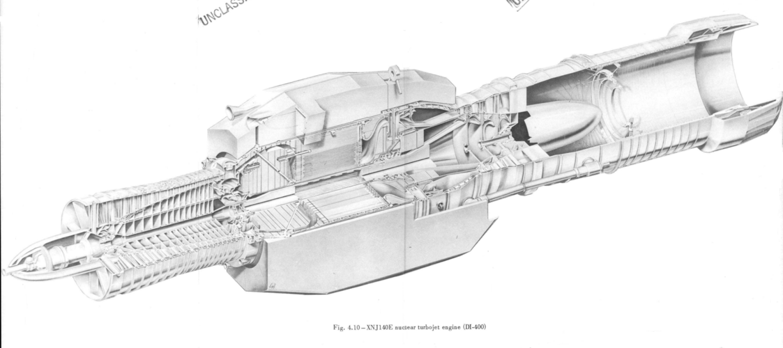

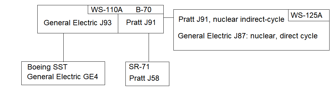

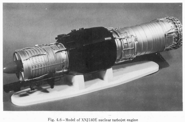

The X211 was designated J87, while the indirect-cycle nuclear engine derived from the Pratt & Whitney J91 that lost out to the J93 in the contest for the B-70 powerplant.

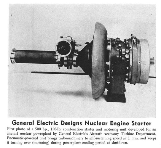

GE nuclear engine turbine starter / sustainer, Aviation Week 15 Feb 1964
