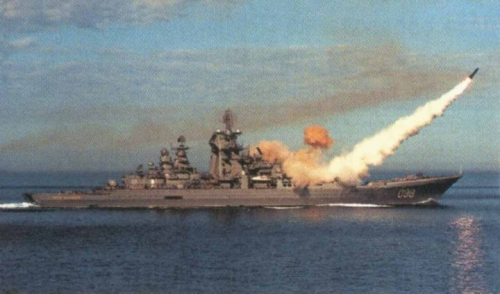

That picture is a land-based Shaddock or Sandbox. (SS-N-3 or SS-N-12) Don't recall the designations for the land-based variants off the top of my head.

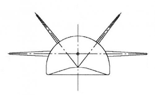

Is there any actual hard information on this? For all we know it could just be a rocket, something like a mini-Shaurya.
Bank to turn config would argue an air-breather rather than (semi-)ballistic rocket, assuming flateric's cross-section drawing is accurate (and, this being flateric, chances are it's going to be ;) ).
EDIT: Also, the domestic variant of the Iskander SRBM pretty much is a mini-Shaurya already - why develop another one?
