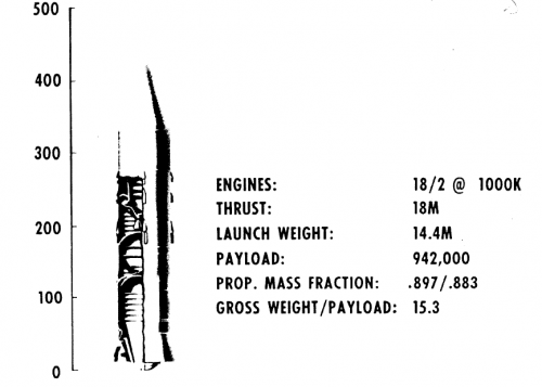

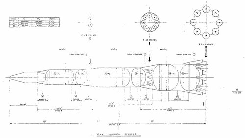

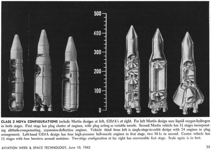

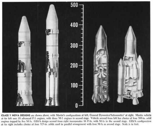

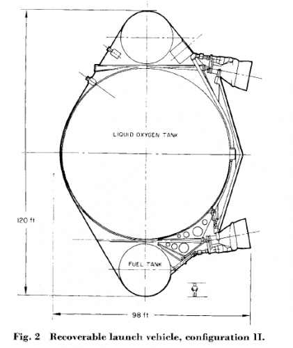

The early Nova design were to land Apollo spacecraft
direct on moon, the Saturn C-8 was last of them (so far i know)

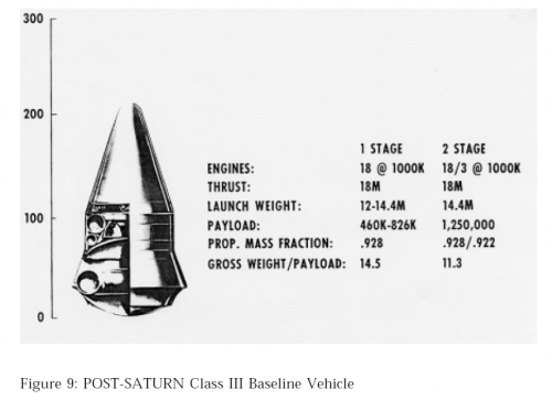

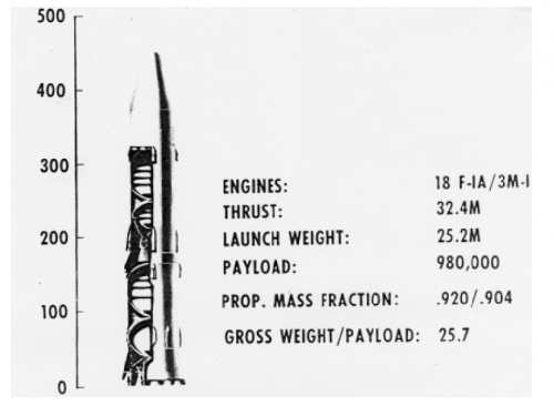

The later Nova design were cargo rocket that bring 1 mio. pound in low earth orbit ( around 453 metric tons)
They wanted solve two problems with this approach
Launch so much liquid Hydrogen at one up, until craft was ready it enough left to feed the Nerva Engine (boil off losses)
Reduce the Launches for Mars ship to minimum

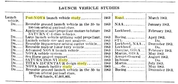

Douglas made one Mars mission study, that only use two Nova launches, the Mars ship and it departure stage.
But at 1964 it became clear there no budget for further Nova studies and no chance they would build them.
From that point Boeing and others look into option to increase the performance of Saturn V into a heavy lift rocket.

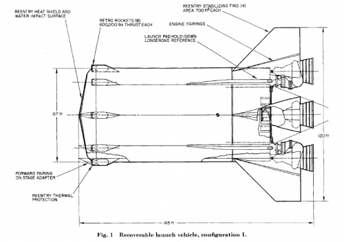

Then they focus on option to use the Space Shuttle as heavy lift rocket.
but in 1973 it became that cheap version with Solids
In 1980s they look into Shuttle-C and ALS and 1990s into Shuttle-Z and NLS
