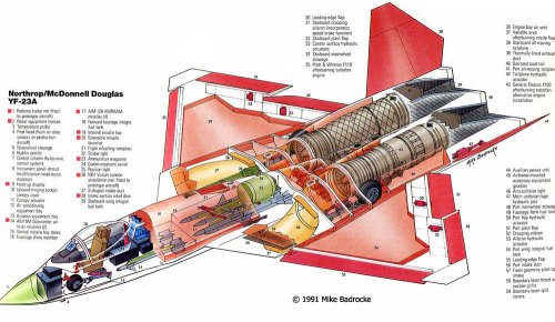

If you look at the YF-23 weapons bay, there are enormous 'patches' in the front and aft walls which could be covers for mounts of a rotary system. Comparitively, the trapeze vee-frames have little if any functional indication of utility (no hydraul connections, no rams or rotary drives etc.).
ARGUMENT:
I find it beyond suspicious that a generic weapons bay with no stealth features took so long to be photographed and when it was, it was a void, the primary weapons deployment feature having been removed. Why? The described system is not anything all that sophisticated. Why pull the pallet? Why show NO PICTURES of the high Mach tests when Lockheed made sure /everyone/ saw the AIM-9 and AIM-120 shots as both video and still?
Indeed, if you look at PAV-2 which is the only weapons bay aircraft we have seen, it makes even less sense-
Because fully a quarter of the forward end of the bay is blocked off by what appears to be cylindrical drive motor containers. Yet look at the distances and the lack of articulated struts between these and the trapezes. If the trapeze have a function, it is strictly as load suspension and pitch alignment (weapons were also canted downwards) not extension/retraction mechanisms.
In fact, I don't think it was a pallet at all. It may have been a pack. But if so, it was a very large one firing missiles that did not drop-clear as the Northrop story suggests, they forward fired as most AAAM illustrations show, from prepackaged tubes.
Alternatively, the rack was in fact a rotary and again, not a flat-tray or pallet.
Now, a conventional rotary launcher will not work in the YF-23 bay because it doesn't have the clearance margin to rotate a weapon past the roof (can't, in fact, if the trapezes are functional lift points). But what if it's not a conventional rotary?
What if it's a fixed spindle and the individual ejector rails, which function as LAU-142s from a complex stacked 'box' condition, rotate around it?
The USAF doesn't like to stack munitions in their internal weapons bays because doing so means that if a single unit fails, it sterilizes the entire system. But the LAU-142 was not pyro based cartridge ejector, it was pneumatic with both an on-rack bottle and aircraft supplied emergency ejection option.
Now, if a weapon doesn't intitialize, you drop it and retract the AVEL and then rotate down the next one. And this is possible by longitudinally displacing the individual launchers on separately geared drives, within or around the spindle.

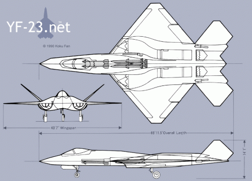

Note the flaws in the following diagram of a three shot trapeze:
http://www.yf-23.net/Pics/Plans/PAV1 weapons bay schematic 1023.gif
There is no place for the pallet to rest that isn't potentiallly conflicted by the carriage box of the period AIM-120A/B weapon fins with their 21" spans, rotated sideways so that their controls extend even higher into the bay. There is no way for the trapezes to swing down without also (assuming fixed not translating pallet hinges) swinging forward and where you have 144" AIM-120s already longitudinally stagger-overlapped by at least 10" to clear the fins, this means you have less than 6" to clear the nose of the bottom most weapon from the bay edge as it passes the -shortest- point in the 160" bay, at the centerline notch.
I don't believe there is enough room for the system to articulate like it is suggested to and it gets worse when you consider door mounting the AIM-9Ms with their own 25" displacement from the panels (remember, the lateral AIM-120s are only partly extended into the airflow and have a 17` outward cant to their ejection axis).

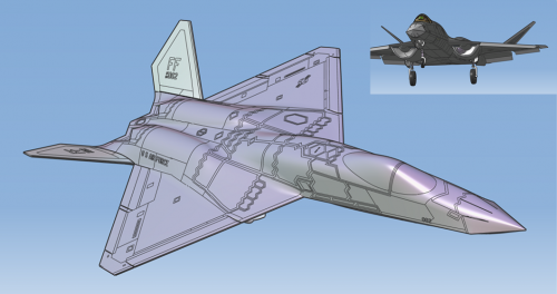

Was there ever a reason given for why the EMD F-23's chine is much less pronounced than the YF-23's? Also, it seems like the F-23 would need a radar blocker as well, since the engine compressor face is visible.
Sorry but I failed to see how the production model's chine is less pronounced. And I don't think the engine is visible given that the production model uses divertless inlets like f-35
Could it be an illusion based on the reshaping of the nose to accommodate a radar?
The production model's nose has a cross section like the F-22's nose; there it isn't a "lip" so to speak, like the YF-23 has at the waterline from the front of the wing to the nose. My guess is they did it because it probably reduced production costs and was aerodynamically just as beneficial as the YF-23's without hurting signature reduction.
In this rendering of the F-23 by user named Stuka, which I believe is based off declassified schematics, shows that the engine compressor face is visible. Of course, I don't know how accurate this model really is.

Sundog said:
The engine face is only visible from an odd angle and there may have been a fan blocker as well. I'm quite sure Northrop knew how to mitigate the fan face return and they aren't about to tell us. ;)
This is true. As these pictures I stole borrowed from the excellent YF-23.net site (reproducing the Koku-fan and World AirPower Journal drawing) show, the engines were buried in the fuselage and were not in line with the front intakes. The front compressor faces would not be visible. No compressor faces would be visible even without the radar attenuators that would have been in the redesigned intakes of the F-23A. Northrop wouldn't screw up like that.
