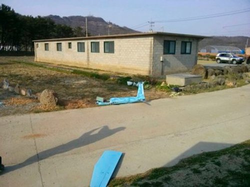

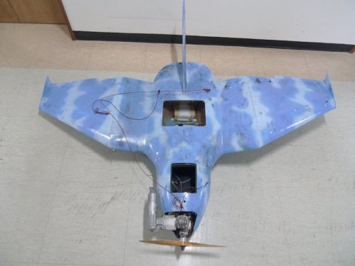

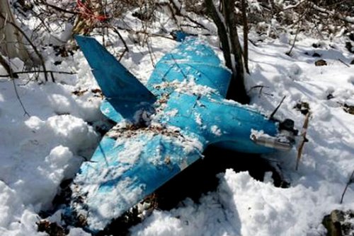

According the German new magazine "Der Spiegel"
The Democratic People's Republic of Korea lost two drones over the Republic of Korea,
While the second drone was found in DMZ between Koreas. a week ago,
The discovery rase unease that South Korea Military, that there Air defense got holes.
source in German language (and include Pictures)
http://www.spiegel.de/politik/ausland/nordkorea-konflikt-suedkorea-meldet-zerschellte-drohne-a-961830.html
http://www.spiegel.de/wissenschaft/technik/drohnen-wracks-aus-nordkorea-in-suedkorea-gefunden-a-962253.html

How to defend airspace against these model planes? Low radar signature to start with and the Spiegel mentions they probably penetrated at below 100m. Apparently the lowest height SK air defense radars can survey. I'm a bit surpised that radar coverage doesn't go lower. It must be one of the best guarded borders on the world and there is a 100m gap?
ROK after receiving information on location of 3rd crashed drone from a farmer and others that came forwards after seeing the photo's of the one drone to say they saw similar drone crash on a local mountain, troops were mobilized in area to search and a third drone was has been found and recovered on the mountain slope in Samcheok
http://blogs.wsj.com/korearealtime/2014/04/06/south-korea-finds-another-crashed-drone/

But I wonder if this NK drone is an off the shelf rc aircraft from china. I could swear that I've seen something very similar looking on an RC aircraft site.
You can buy off-the-shelf fixed wing RC models, even quite large ones with a remarkable payload, that
are just meant for photo/camera flights.

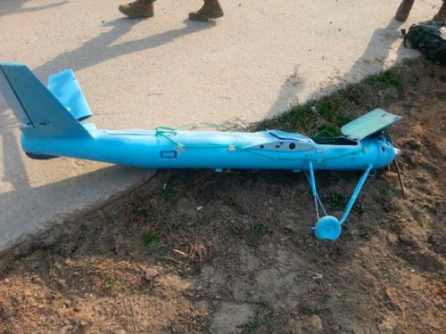

Seems to be a Chinese design:
http://lt.cjdby.net/thread-1821740-1-1.html
Deino
North Korean UAV is Chinese-made SKY-09P
One of the North Korean UAV that crashed in South Korea has been identified as coming from China.
The SKY-09P is manufactured by Taiyuan Navigation Friend Aviation Technology Co. Ltd.
This company was formed in July 2003 and is based in Taiyuan city, Shanxi province.
According to the company’s datasheet, the UAV has a speed of 80-100km/h and a range of less than 40km. It can carry a payload of 3kg and is recovered by parachute.

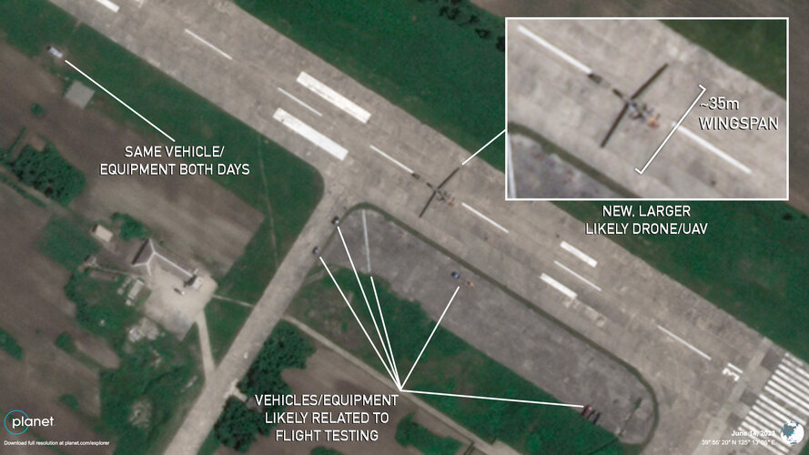

35 meter wingspan !!
So they are working/fielding on RQ-9 and RQ-4 class UAVs. Most interesting timing, 2019 RQ-4 shot down, 2023 DPRK builds a smiliar UAV...

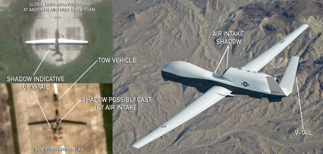

We know those things are tested since at least mid-june (satellite photos).
Chance that those are fake IMHO is very low, Korean footage is just always like this.

(3)Very obvious SATCOM fairing(or they hid there a ground datalink?). But what satellite? Sign of a future program? Or friendly?
