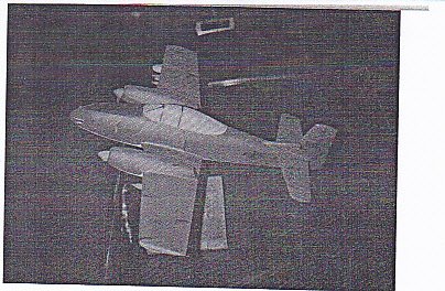

I'm surprised this isn't already mentioned here other than in passing comments. Anyway, I found this photo copy in one of my folders and don't know where I got it so I can't credit it to anyone. It may be a copy out of one of several books I have. I can't locate a couple of books I have on the T-28 at the moment (in storage) and my first sighting of the AT-28F was in a book from the late '70s / early '80s, IIRC, called "Closet Cases", again IIRC. Anyway, it was a proposal by Volpar to install 2 Garrett TPE-331s of some sort and a large nose cone in place of the radial engine. I've not seen a lot of info on the proposal.

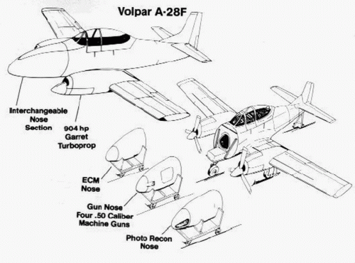

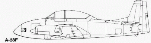

Topics merged ;) and as an add-on two drawings from Squadron Signal N° 89, which mentions
the Volpar AT-28F, too. The piston engine was replaced with two Garrett TPE 331-3U turboprops
of 904 hp each, using so-called "Package Power Conversions" off-the-shelf propulsion units.
The nose section, repacing the piston engine was detachable and easy and quick exchangeable.
Noses with four .50 caliber guns, ECM equipment or for photo recce were designed.
Additionally the AT-28F had six underwing hardpoints for up to 4,000 lbs.
Claimed performance were a top speed was 330 mph, service ceiling of 28,000 ft and a range
of 1,540 miles (2,800 with aux tanks of 165 gallons each).
