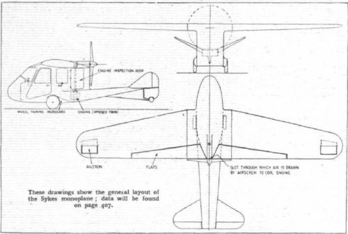

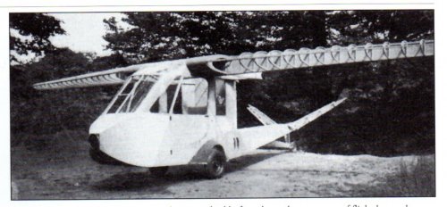

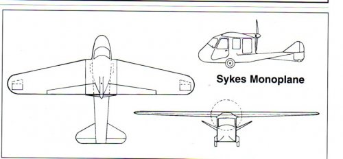

A photograph and another three view drawing.
[source: A.W.J.G.Ord-Hume - British Light Aeroplanes Their Evolution, Development & Perfection 1920-1940]

I don't agree with you, VictorXL188. If you contrast the photographs of the Hillson Pennine (British Civil Aircraft (Jackson), vol. 3, p.254) and the Sykes Monoplane (British Light Aeroplanes (Ord-Hume), p.479)(I can't refer to the Flight article as the current publisher of the magazine has withdrawn its online archive), they are as different as chalk and cheese. I have no reason to believe other than that these were two separate and distinct aeroplanes, not one and the same.
From Ord-Hume:
'The Sykes Monoplane was virtually complete by the end of autumn [1936] but there is no record of it ever being registered or any attempt at flying it. It seems more than likely that the project was thoughtfully abandoned before it could cause serious damage to anybody's health.'
and:
'However, Norman Sykes and his leading edge spoilers turned up the following year [1937] with furniture-makers and Praga Baby-builders F Hills & Sons of Manchester. Seeking a replacement for the Praga, this company sought the services of Sykes who designed a new machine for them. Hills built a machine called the Pennine, which had a fixed fin but no rudder and small spoilers on the leading edges of each wing ..... .This was followed by another of Sykes' creations, a shoulder winged monoplane called the Helvellyn which was more conventional in appearance (save for its peculiar 'horn-balanced fin).'
Thus the Sykes Monoplane (i.e. that illustrated in Hesham's original post in 2008 and my subsequent post in 2013) preceded the Hillson Pennine and Helvellyn and the only thing that the three aeroplanes had in common was a designer. Thus I would suggest respectfully that VictorXL188's post should be transferred to a new topic entitled 'Hillson Pennine' and that it might be helpful for this topic to be retitled 'Sykes Monoplane' because, as far as I am aware, Norman Sykes designed only three aeroplanes and there would then be a discrete topic for each of them.
