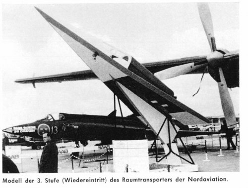

the german text say
Model of Third stage (reentry) of the Space Shuttle by Nord Aviation.
this part is a Rocket so a space project !
Barrington Bond, what is the source of pictures ?
Michel,
One was from Der Fleiger 7/69 Page 256 the other I think was Flug Revue I forgot to note that. I though VERAS was hypersonic research - perhaps the writer was wrong?!
Regards,
Barry
Indeed, VERAS stands for "Vehicule Experimental de Recherches Aerothermodynamiques et Structurales" / Aerothermodynamic and Structural Research Experimental Vehicle.
Nothing to do with a space shuttle project.
Thanks for info, Barrington Bond and Retrofit
The German text made mistake, it label it as Spacecraft
This is a hypersonic research vehicle launch by rocket

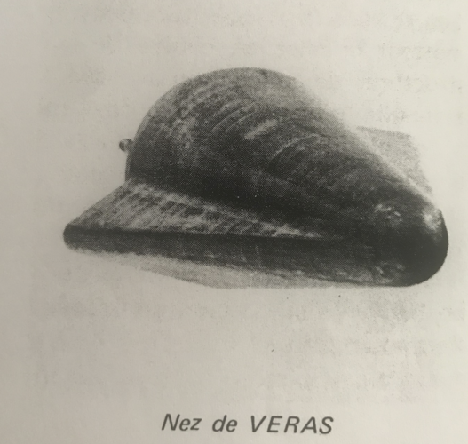

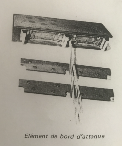

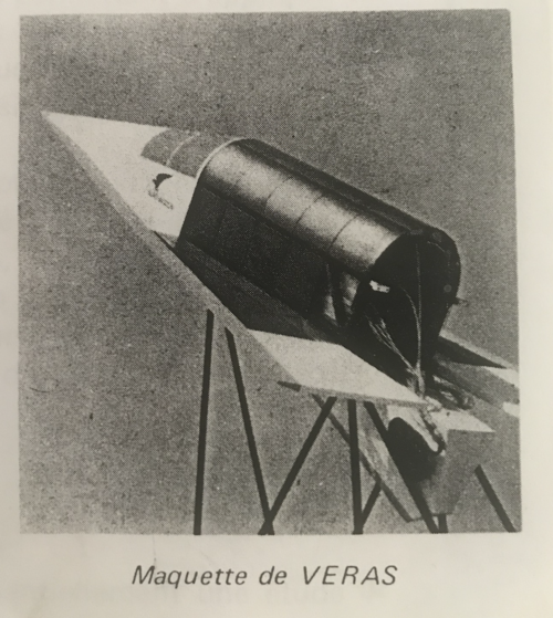

VERAS program mockup and test articles:
- nose
- leading edge elements
Enjoy.
A

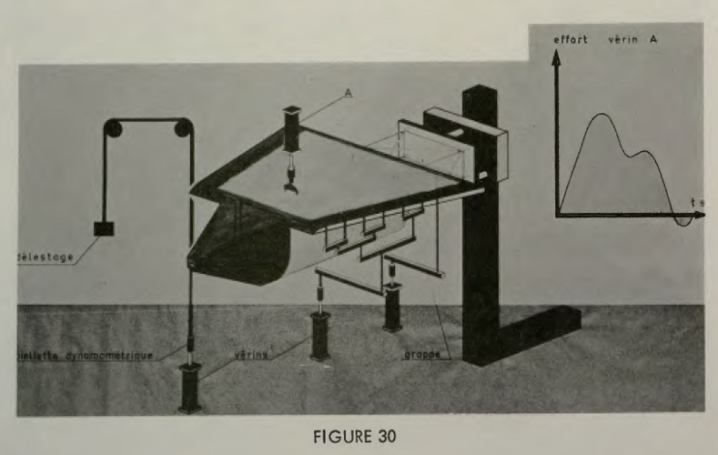

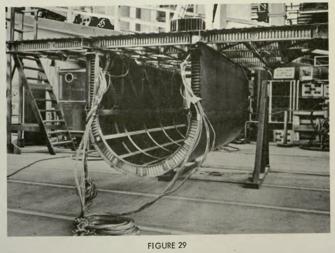

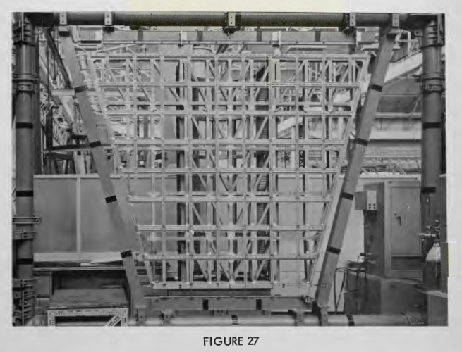

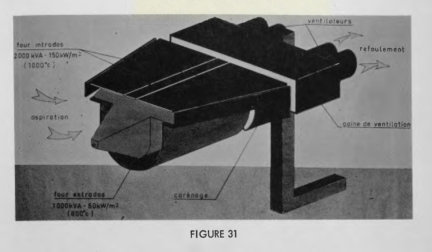

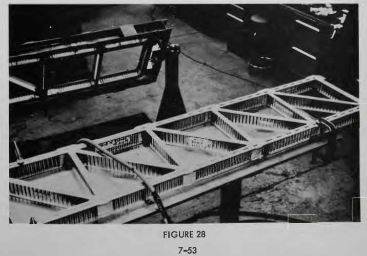

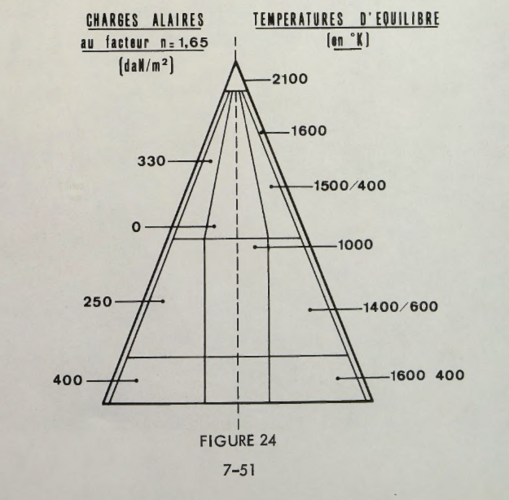

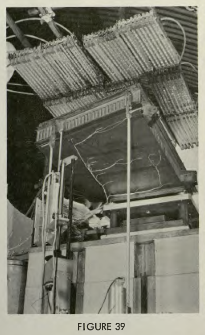

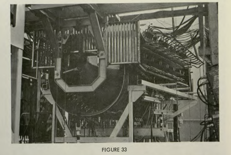

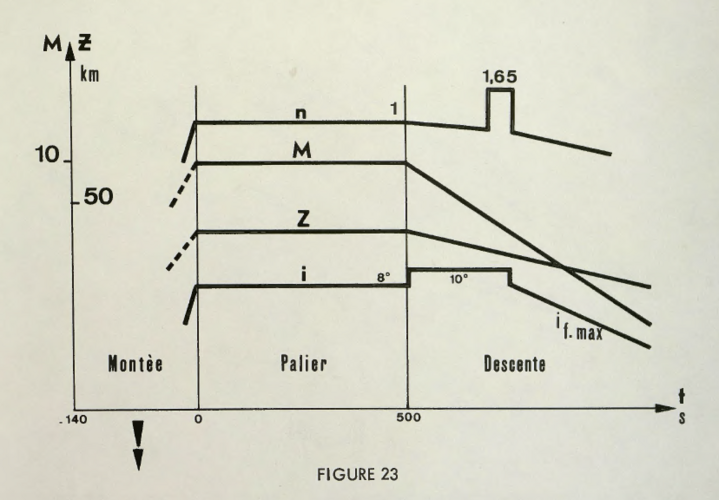

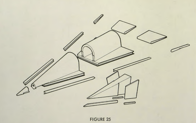

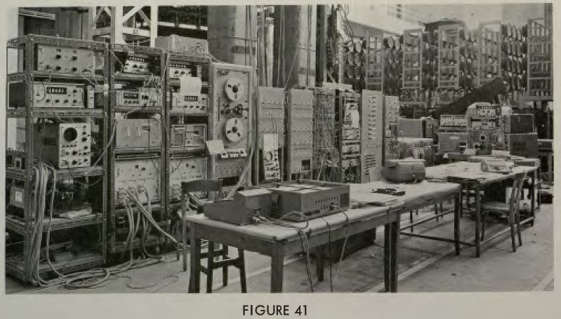

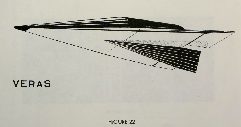

Additonal stuff for the sake of completion.
A
Hi.
BTW, the logo on the mockup tells something about the project. If you pay a close attention, it is NOT Nord Aviation's logo but it looks a lot like it. I can't read through it, but the writing clearly is NOT a single "N" standing for "Nord"
Thus, quoting from wikipedia:
On 1 October 1954, Nord Aviation was created as a result of the acquisition of SFECMAS (Société française d'étude et de construction de matériels aéronautiques spéciaux) by SNCAN (Société nationale de constructions aéronautiques du Nord).
SNCAN, (abbreviated from Société nationale des constructions aéronautiques du Nord), or commonly, Nord, was a state-owned French aircraft manufacturer in the pre- and post-World War II era. The company had been formed as one of six state-owned Société Nationales in the 1936 reorganization of military industries, and was created by the nationalization of several aircraft factories in the north of France. It survived until 1954 when it merged to form Nord Aviation.
On 1 March 1970, Nord Aviation merged with Sud Aviation to create Société nationale d'industrie aérospatiale (SNIAS), which was promptly renamed Aérospatiale. In 2000, this company merged into European Aerospace Corporation EADS, which was then renamed to the Airbus Group.
This is where we stand for better archival hunting.
A.

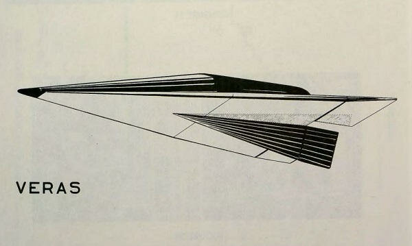

Translated elements from french site Opex360:
Quand la France avait de l’avance dans la mise au point d’un planeur hypersonique avec le projet VERAS
When France was ahead in the development of a hypersonic glider with the VERAS project
In 1965, the DRME gave the Nord-Aviation company the task of carrying out a study to produce this hypersonic glider. Other companies and laboratories were involved, including Carbonne Lorraine, Pechiney, the National Institute of Applied Sciences [INSA], the University of Poitiers and the Toulouse Aerospace Test Centre [CEAT].
This alloy "presents interesting characteristics at high temperature, while remaining suitable for the production of thin sheets and retaining good forming capacity. Moreover, its oxidability remains within acceptable limits for short-term service, and its weldability is satisfactory.
The results of the feasibility study for this programme were presented to the Ministry of the Army in 1967. And it was decided to proceed. Officially unveiled in 1968 and presented at the Paris Air Show the following year, the VERAS was finally cancelled in 1971, a few months before its first flight, scheduled at the Landes test centre.
Jean-Christophe Carbonel also talks about VERAS in his book "French Secret Projects 3".
