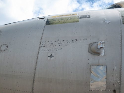

It's possible that the WB-47s were also re-designated W-47. I took a vacation in Utah last month and visited Hill AFB, where there is a WB-47E on display, marked as a "W47E-12-BW." More pictures on my my Photobucket
