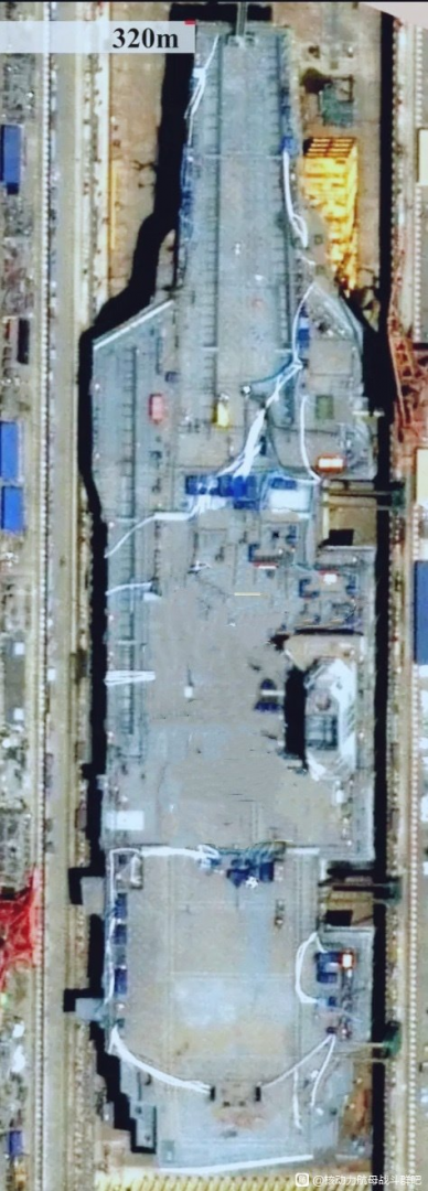

^ assuming those dark lines are where the catapults will be
is it me or is the starboard side catapult look really close to the edge?
You are not alone helmutkohl, I thought that myself that the starboard catapults were way too close to the edge. Perhaps Deino will help with this issue.
Perhaps we are mistaking catapult support structures for the catapults themselves? The actual catapult tracks could be attached to, and inboard of these structures a bit.

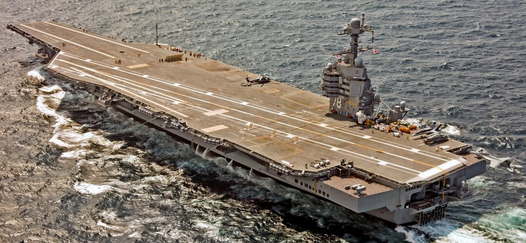

Ford class is the same IMO,

The latest image of the Type 003 aircraft carrier shows the deck is indeed almost closed.
(Image via @核动力航母战斗群吧 on Tieba)
