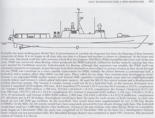

I posted a thread a while back that included a 1980s Mobilization Frigate. You can see both how incredibly austere it was and how much effort would still go into building it. And that's before the cruise missile threat became as severe as it is today.
Post in thread 'Obscure USN Frigate concepts and studies' https://www.secretprojects.co.uk/threads/obscure-usn-frigate-concepts-and-studies.39022/post-522292
I guess we're at cross purposes. Nothing as small as a PC (even at 600 tons) can be a useful replacement for a major surface combatant. The minimum for that is a few thousand tons and a surprising amount of long-lead electronics. I think a naval war with China is probably much like WW3, a come-as-you-are affair with very little time for new builds
Agreed, that Mobilization Frigate is probably the smallest possible hull that is actually capable of being useful. Somewhat ironically, IEP like the diesel-electric drive is currently all the rage.
