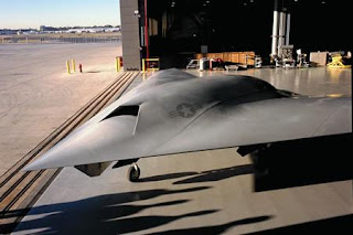

Has anyone thought of the concept artwork of the fighter the late Pierre Sprey wanted to be in mass production with rugged simplicity high reliability & a fast turn around time of less than 6 minutes
