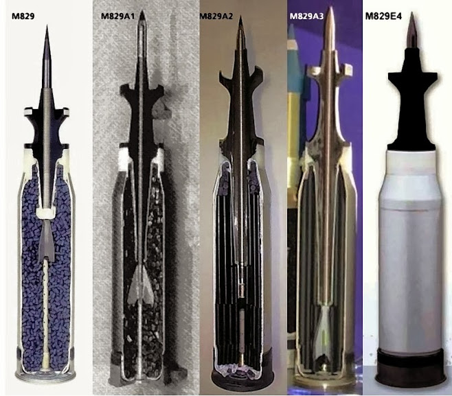

If the effect of mass (which is really rod length) wasn't "as important as we would think" the development of LRPs wouldn't look like this:
qdS8u5FghQavCwKjPMrWDLLsVR-qs9kag3yPS9zlAqY=w658-h577-no

In actuality the M829A3's velocity is a result of maximizing the gun's energy efficiency by increasing the penetrator's L/D ratio and strength (particularly bending stiffness), qualities which are more important than velocity or even material selection (within reason, of course) in determining penetration.
In fact, I bet if you ran the math you'd see the most efficient velocity for any tank gun firing penetrators with an aspect ratio of ~32 would about...1540 meters per second.
