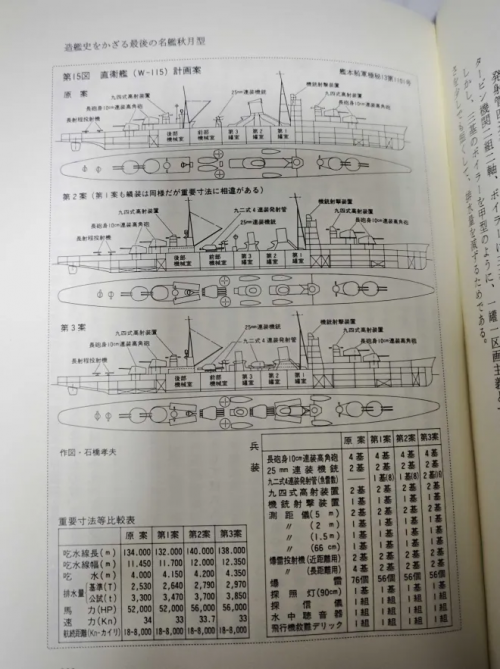

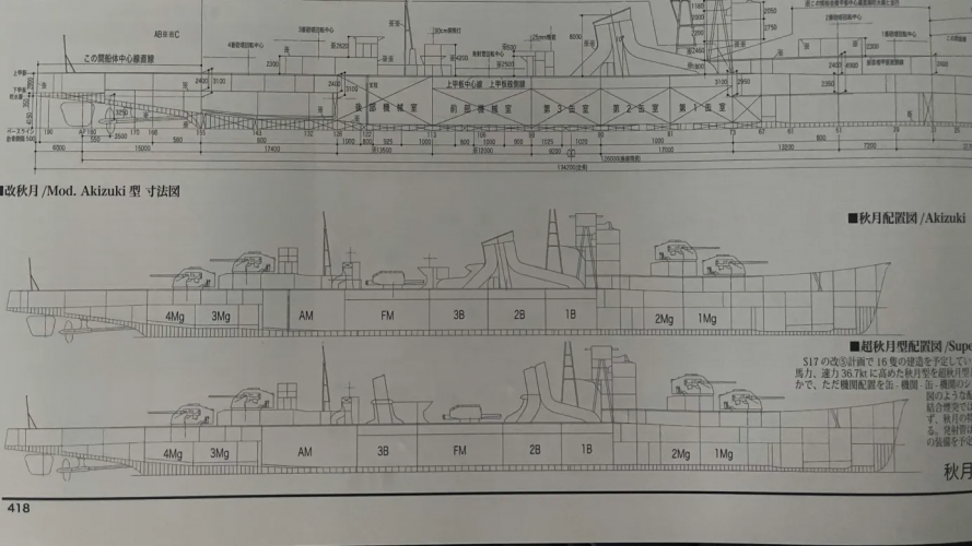

With regards to the super Akizuki, is there a length and drawings that go with it?

There are no dimensions data or drawings for the V-6 and V-7 projects.

A question: (sorry for bringing up the old post.) Any information about whether the V7 Super Shimakaze would have 3x6 61cm Torpedo Tubes? and V6 Super Akizuki would have 1x6 61cm??
Shimakaze-Kai apparently would had sextuple tubes. Akizuki-Kai unknown but likely.
Based on an appendix in Lacroix and Wells' Japanese Cruisers of the Pacific War, The Akizuki-Kai was to have a Sextuple Longlance mount.
