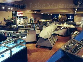

This time it's called Recoverable Test Vehicle lol.
http://www.chinalakealumni.org/IMAGES/2000/Recoverable%20Test%20Vehicle%2028JUL00%2009NMAT.JPG
On this page, it is described as follows:
RTV Recoverable Test Vehicle (T&E tool; not a weapon)
Since it's an index from the China Lake Museum, I guess it can be trusted... but what does T&E mean?

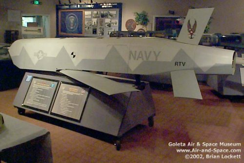

We had 3 test flights before they canceled the project.
On the first flight, the lateral accelerometer polarity was reversed and it went into a flat spin and landed in the mountains.
On the second flight it flew successfully although the control system performance was poor. The yaw axis had a mild spiral mode instability at higher AOA, which I fixed with a control system redesign.
The third flight was completely successful, with the remote pilot saying it flew very nicely.
It was expensive to repair the scratches it suffered after each landing (on its back) and re-qualifying it for captive carry again on the A-7. We had no customers by that time so it was scrapped, but it had an impressive lift to drag ratio, and range when dropped from 40,000 feet.
A fun project to work on. It used the same data link as the QF-4 for control and telemetry.
