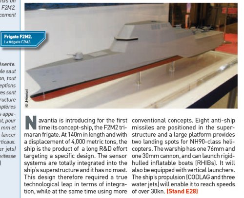

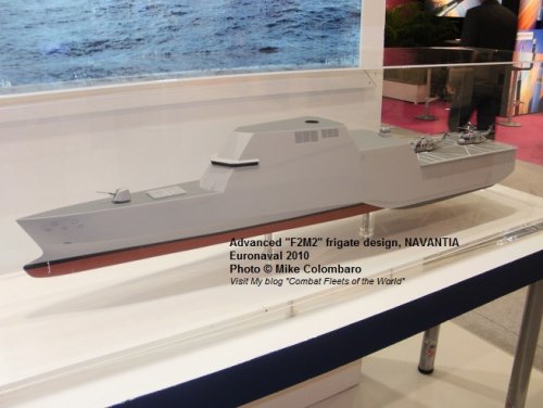

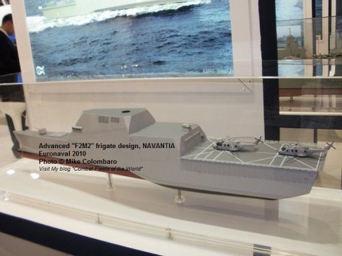

Navantia F2M2 (Future Frigate Multi Mission) concept on display at Euronaval 2010.

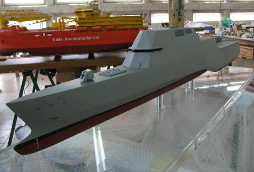

Model of Navantia F-110 frigate for the Spanish Navy.

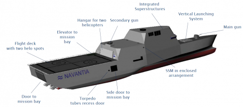

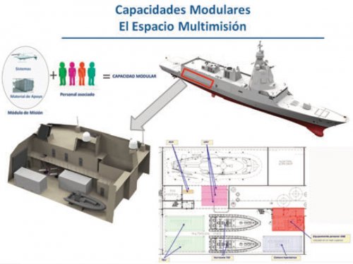

LCS-2 with less junk in the trunk? Why go for less beam, if the major capability is the mission bay?

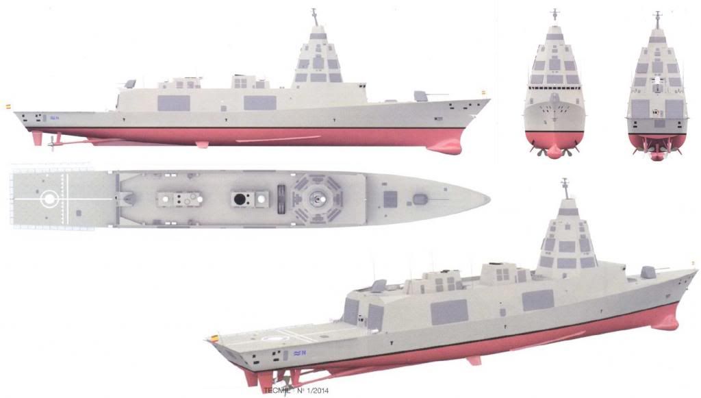

To be fair, the latest concept officially shown by the Spanish Navy are a bit more conservative...
Still shows a "espacio multimisión"/multifunction space which can be used to held specialized containers tailored to the planned mission. Note that the main gun is still "3/5in" but the design shows a Mk45 Mod 6, which seems to be what the Navy wants. The current Mod4 are refurbished US Navy surplus so it would still be a cheap option to get more ex US Navy mounts, if available, which can be upgraded to Mod 6 in the future.
Note the flight deck is capable to hand either the NH-90 or the SH-60, although the Navy would prefer the later. A small batch of stored SH-60F has been purchased to replace surviving SH-3s. These would be modified as transports and used as assault/cargo helicopters.

The most up to date model is the one posted by Gorka.

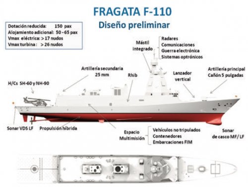

Here, another image extracted from Tecnologia Militar magazine:
Regards

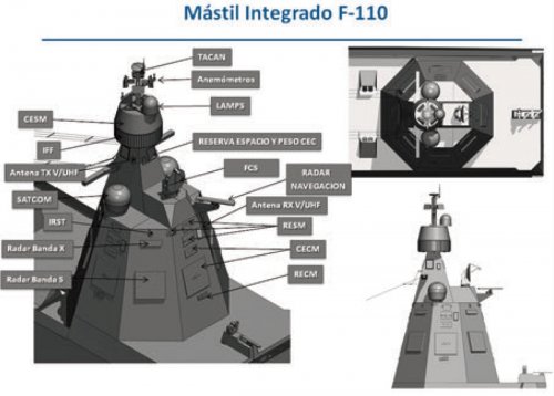

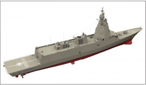

I'm going to go ahead and say that mast design is notional, 8 faces is a bit overkill even if most of those panels aren't radars.
I think so too, although Navantia & Indra have created a joint venture for developing the "integrated mast/superstructure" and the goal is to insert as much sensors as possible.
Furthermore, there is some approach with CEA-Technologies as a potential supplier of hardware and knowledge for the radars (basic version of CEA-FAR has 6 faces)
Even so, I agree that 8 faces seems overkill.
Regards

In fact, Indra is supposed to develop an new active array radar system for the F-110 class, which seems to me a bit of overkill. The mast would also house EW, datalink, comms, surface search radars and basically all the electronic gear for the ship.
The eight faces may be related to the need to hold everything and keep radar cross section low, but would also mean the main radar panels would be rather small affecting range.

Nope. The F-110 is simply the F-100 ship without AEGIS and a single gas turbine. The trimaran design would have been a concept study to keep their naval architect's pencils sharp until something more realizable came along.
The trimaran was one of the design possibilities studied, but was rejected as it was the noisiest option, which isn't a good idea on an ASW ship.
The current design has hybrid propulsion with electric engines, the heaviest option but the quietest one.
