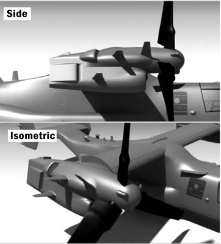

Navair to test special version of winglets on V-22.

I had been wondering if Formula 1 style aero package winglets would appear on aircraft. This beast was never a looker, the addition of warthog like tusks on the nacelles hasn't helped! If they work however then bolt em on!
After some thoughts, I wouldn't expect them to act like conventional winglets, as they aren't working in the
relatively calm airflow of te wing, but in the wash of the rotorprops.
Structurally, they are a pain; requiring the addition of several structural members to the nacelle structure.
And therefore; added weight. The bane of all aircraft.
Well, a production version would optimize the nacelle design to add these. This is a flight test effort and isn't as refined. The same holds true for some of the other projects in work or test on the V-22.

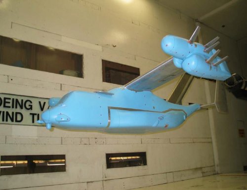

Holy Bananas! So happy to see elmayerle's back!
flateric said:
My goodness! They will have to change the name from Osprey to Porcupine.
