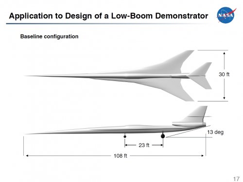

thrust vectoring nozzle could be for reduction of trim drag at high-speed. Or, less likely, being able to more quickly rotate the airplane on takeoff.
ftp://lbpw-ftp.larc.nasa.gov/outgoing/aviation-2014/OrdazGeiselhartFenbert-Design-Boom-Trim.pdf
semi-final, non-proprietary NASA LBDEF configuration

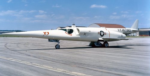

I can't help but wonder if the X-3 Stiletto might have been able to give them any earlier insight into this if they'd actually been able to go supersonic with it.
