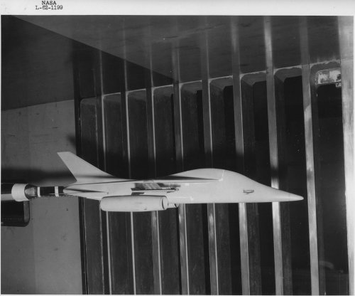

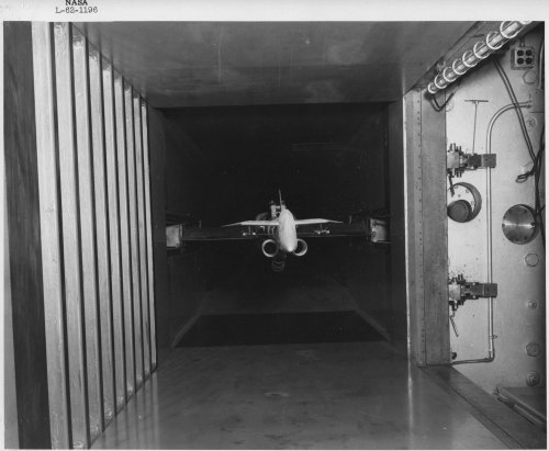

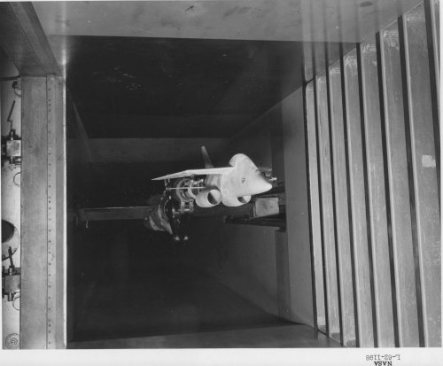

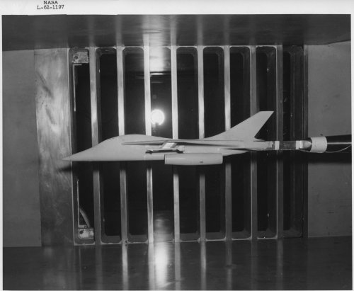

Here's what appears to be a very odd VAX design from 1962.
In Ailes 13/7/1962,
I found this strange VG STOL Fighter Project,and it was appeared in Aviation Week Magazine,I made a good
search in its archive,but nothing I found,maybe it was not a generic design,so if anyone can help ?.
Maybe you are right,but who can find it in Aviation Week magazine ?.
This is the Langley "Little Boy"
littleboy-jpg.630806
At those extreme sweep angles, the outer wing panels essentially “disappear.”
You then depend upon lift developed by the sharply-swept, wing-root, leading edge ….. more like a gothic wing.
