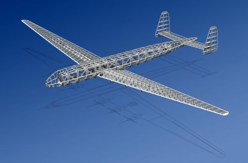

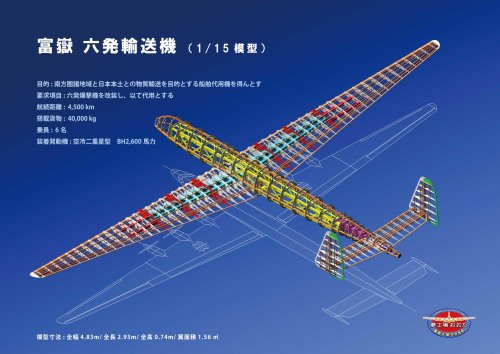

One of the Nakajima unknown projects!
Z-transport : Ramge ; 4500km, Cargo(payload) : 40ton, Crews : 6, Engine : HA-44(BH) 2600hp×6.
Perhaps this aircraft was Z-Ohta bomber base design. (Z-Ohta : HA-54(HA505,Double BH)5000hp×6).
Range was short compared with Z-Ohta, but payload was large.
Span : about 72~73m, Length : about 44m, Height : about 11m, Wing area : about 344 square meter.
The purpose : Airplane as substitution of the transport ship which performs cargo shipment between south areas and the mainland of Japan.
Please watch 1/15 scale model size at bottom of the drawing.
(Span 4.83m, Lenght : 2.93m, Height : 0.74m, Wing area : 1.53 square meter)
