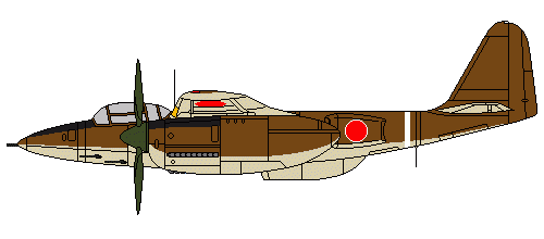

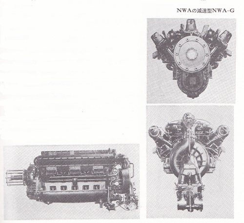

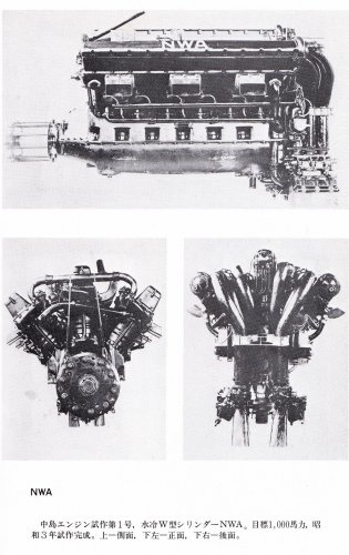

This picture shows Nakajima NWA not inverse not supercharged W18 liquid cooling engine.Prototype was completed in 1928.
NWA 1,000hp class engine development was Chikuhei Nakajima's private order.
NWA-G had a supercharger.
Ha-39 was almost a inverse type NWA engine with two speed supercharger.
Source : The history of Nakajima aero engines,Kanto-sha, 20/5/1985, ISBN4-87357-007-7

airman said:
http://www.warbirds.jp/kakuki/kyosaku/1ki/ki82.htm ( it was a real project )
Obviously what if image.
The truth also seems included in information on this site.
Such site is really troublesome. ;D

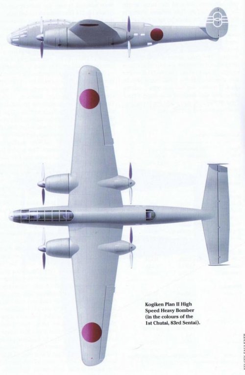

Nakajima Ki-82 coul be related with Kogiken plan II ? https://forum.warthunder.com/index.php?/topic/128381-rikugun-kogiken-series-you-will-love-these-aircraft33/
Oh! But Kogiken planⅡ was a light bomber.
