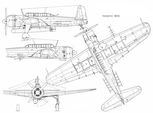

A version with 4 machine gun 13 mm on wings and 7.9mm defensive gun and speed 491 km/h , taken by Kagero about Tenzan . Anyone know more about this version ?

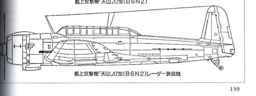

You meant this one.
In japanese sources B6N2a seems be armed with four wings 13mm guns . Obviously the machine gun 13 was a Type 2 machine gun : an adaptation of germany mg131.

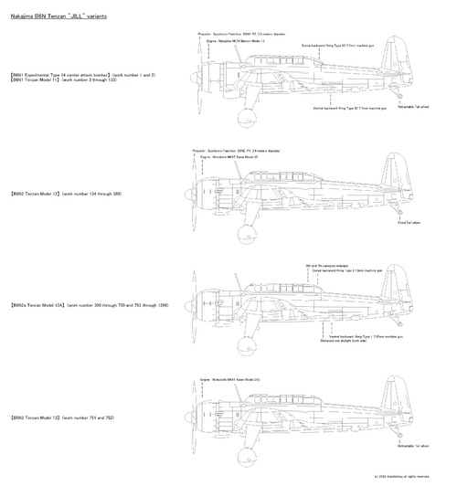

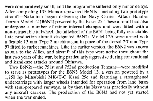

https://weaponsandwarfare.com/2018/12/20/nakajima-b6n-tenzan/
"Nakajima B6N2a – This type differed from the B6N2 only by having a rear firing machine gun of 13 mm (0.51 in) calibre, instead of the 7.7 mm (0.303 in) type used on the B6N2.
Nakajima B6N3 – Two conversions of the B6N2a resulted in the B6N3 prototypes equipped with 1,850 hp (1380 kW) Mitsubishi MK4T-C Kasei 25C engines for evaluation as land based bombers."

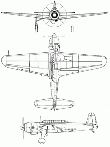

Up to the B6N1 No70, it was equipped with a 7.7mm fixed machine gun in the left wing, which is unusual for a Japanese Navy ship attack aircraft. It was equipped to control enemy ships' anti-aircraft guns during a torpedo attack, but had been discontinued since Unit 71.

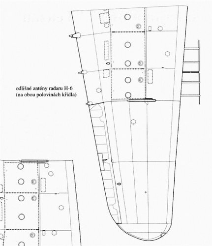

I suppose real plan because i have seen it on Maru Mechanics ( i attach cover)

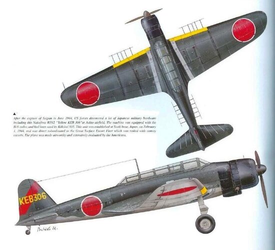

This is not the B6N but the earlier B5N Kate, fitted with the H-6 radar. Notice how the wing antenna when viewed from the side look like gun barrels:
  • B5N2-12 931st Ku, tail code KEB-306, equippped with H-6 radar, Aslito AF, Saipan, Marshall Is,...jpg
  • B5N2-12 931st Ku, tail code KEB-306, Saipan, 1944, equipped with H-6 radar.jpg
That actually makes sense. I can definitely see the similarities between the gun barrels and the radar antennae. Also, in the original B6N picture, you can actually see the radar antennae on the sides too.
